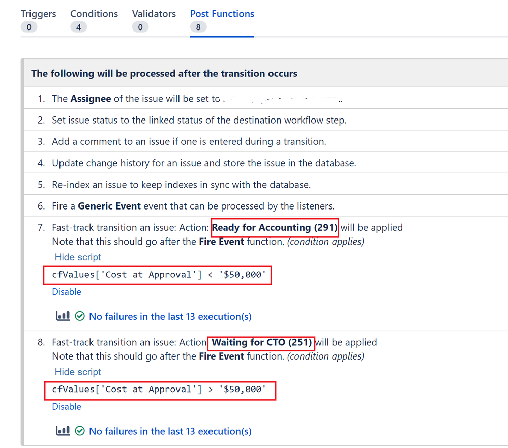

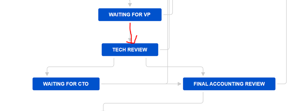

Hi Team,
We have a requirement that the transition from "Waiting for VP" to Tech Review", If the cost at Approval is less than 50k, the transition will go directly to "Ready for Accounting", if its more than 50K, it will transition to "Waiting for CTO". It's working as expected, but if we give the value of 100k or more than 100K, it's not working. It's working for the value of $99,000.
Does anyone have any idea why it's not working on $100,000 or more than that value?
I am using Fast-track transition an issue [ScriptRunner]

Looking at your screenshot, the approach doesn't seem to be correct.
When you are using < (lesser than) and > (greater than) operators, it will only work for numeric values.
However, in your screenshot, you are using it against a String value, i.e. '$50,000'. This will not work.

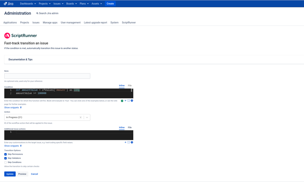

Instead, it would be best if you tried something like this:-
def amountValue = cFieldValues['Cost at Approval'] as Long
amountValue >= 50000
for greater than 50,000
and something like this
amountValue < 50000
for lesser than 50,000 and see if there is a difference.
In my environment, I tested for greater than and equal to 100,000, which should automatically transition to In Progress upon creation, and it works as expected.
Below is a screenshot of my Fast-Track Transition:-
I hope this helps to answer your question.

Thank you @Ram Kumar Aravindakshan _Adaptavist_ for the correction. It's working now.
def amountValue = cfValues['Cost at Approval'] as Long amountValue < 50000
But it's good if we provide a value like "$49,000", it makes scenes to users how much amount it is exactly.
