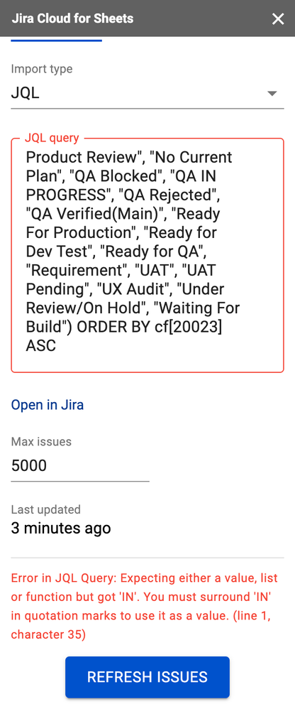

I have connected my JIRA to Google Sheets, and am trying to fetch issues using Basic querying, but I'm seeing a persistent error:
Error message: "Error in JQL Query: Expecting either a value, list or function but got 'IN'. You must surround 'IN' in quotation marks to use it as a value. (line 1, character 35)"
The same query was successful in populating the Google Sheet with JIRA issues in the past

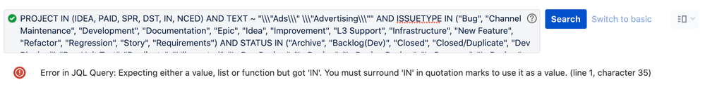

I tried your approach but found that the same error was occurring in the JIRA advanced issue search as well.
While I know it isn't ideal to be asking for fixes to my search formatting, could you please help here?
Full query for your reference:
PROJECT IN (IDEA, PAID, SPR, DST, IN, NCED) AND TEXT ~ "\\\"Ads\\\" \\\"Advertising\\\"" AND ISSUETYPE IN ("Bug", "Channel Maintenance", "Development", "Documentation", "Epic", "Idea", "Improvement", "L3 Support", "Infrastructure", "New Feature", "Refactor", "Regression", "Story", "Requirements") AND STATUS IN ("Archive", "Backlog(Dev)", "Closed", "Closed/Duplicate", "Dev Blocked", "Dev Unit Test", "Duplicate", "Hibernated", "In Dev Review", "In Design", "In Design Review", "In Progress", "In Review", "Need Confirmation", "Need More Info", "Need Review", "Needs OneList Review", "Needs Product Review", "No Current Plan", "QA Blocked", "QA IN PROGRESS", "QA Rejected", "QA Verified(Main)", "Ready For Production", "Ready for Dev Test", "Ready for QA", "Requirement", "UAT", "UAT Pending", "UX Audit", "Under Review/On Hold", "Waiting For Build") ORDER BY cf[20023] ASC

Thanks for that info!  I can see now that you have a project key called "IN".  Since this is also a reserved JQL term, the parser in JQL is getting confused.  You need to surround this with either single or double quotes for this to work.
Take this first part of your query:
and change it to
PROJECT IN (IDEA, PAID, SPR, DST, "IN", NCED)
Then run the search.  Once you do that, you should then able to use that same JQL over in Sheets as well.
