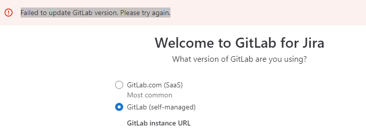

Hi there,
I faced an error on setting Gitlab for Jira, when i'm trying to choose self-managed version. Anyone could help with it?

Admin (Jira)
January 20, 2023
Hi Fabio,
Thanks for your response. Actually it is happened in the very beginning of configuration. There is a choice of 2 version, SaaS and self-managed as it shown bellow:
And i will check guide once more
