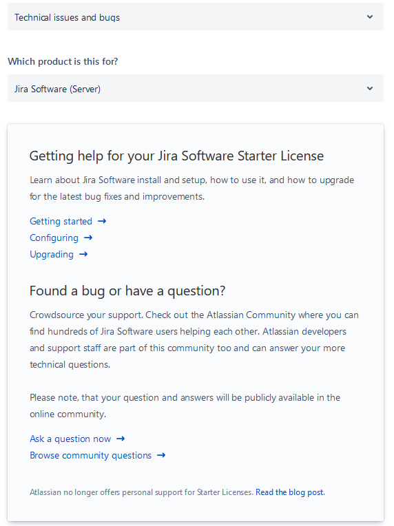

Strange... I can't open an issue with Atlassian Support, I get only directed to the atlassian community...

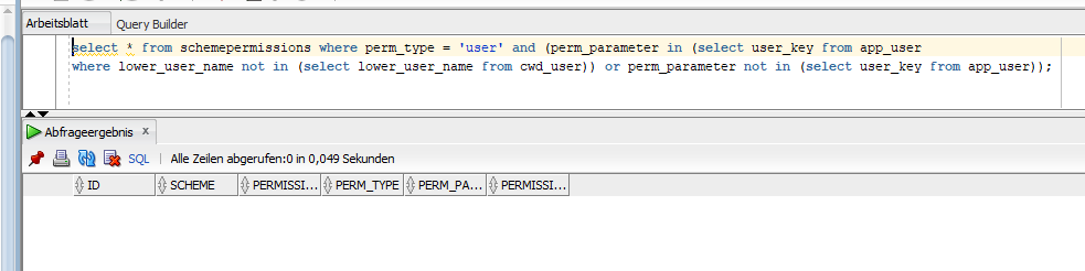

And the select from schemepermissions doesn't return anything.

Looks like you are on starter pack, hence it is redirecting to community support.
This one select from schemepermissions how did you run ? can you send screenshot.

it is our testing environment with just 10 Users, but we did get support in the past for it..
I guess because it's JIRA Server, they no longer support.
I selected like this:

That's correct starter packs aren't supported.
I see the query and results, if nothing is shown then you are not affected by the issue as mentioned in resolution kb.
