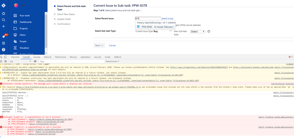

Fail to convert issue to subtask
Ihor Barinov
January 21, 2020

Hello @Ihor Barinov ,
Thanks for providing the console details, and checking out the error:
'Unchecked runtime.lastError: The message port closed before a response was received'
I found several hits on various forums indicating that the error you are seeing is most likely related to a browser extension causing the failure to occur,
EXE, in the following Stackoverflow post as user encountering this error relating to the the browser extension "Video Downloader professional":
And the following thread on a Github forum for the tool caused by a different Extension "Live Server":
I recomend disabling all browser add-ons as a first step to see if this is the case, and let me know what you find.

Hi!
Hm, that's interesting.
Because I met with the same, but i use the private mode.
