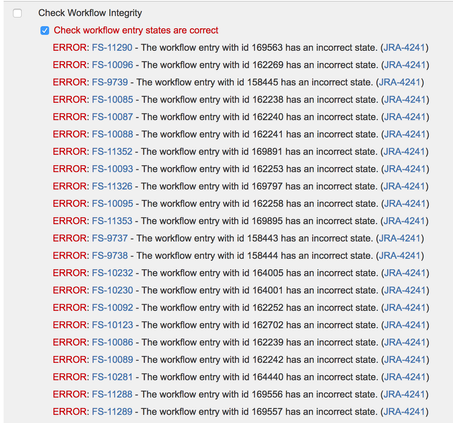

@Petter Gonçalves
Hi Petterson,I had run the integrity checker by choosing the option "check workflow entry stated are correct"
But I could notice the error stating as per the attached screenshot.
I referred to the original bug report "https://jira.atlassian.com/browse/JRASERVER-4241"
But i couldn't found the exact solution steps what i should do to fix this.
As well as i retrieved the value from my database using a query,
select jiraissue.pkey, jiraissue.workflow_id, OS_WFENTRY.* from jiraissue, OS_WFENTRY where jiraissue.workflow_id=OS_WFENTRY.id and ( OS_WFENTRY.STATE is null or OS_WFENTRY.STATE = 0);
The result here is a table that didn't return any pkey value.(I have posted 2 rows values for example, but the actual output holds 22rows)
pkey | workflow_id |   id   |                 name                 | initialized | state
      |      169563 | 169563 | Final  - Story Workflow |             |     0
      |      162269 | 162269 | Final  - Story Workflow |             |     0
What does the workflow_id and id columns value? From where this values are been fetched?
Do I need to change anything with my current workflow?
Please do clarify me what the exact problem here?
error due to re-indexing? workflow error? or something else that I should know?
