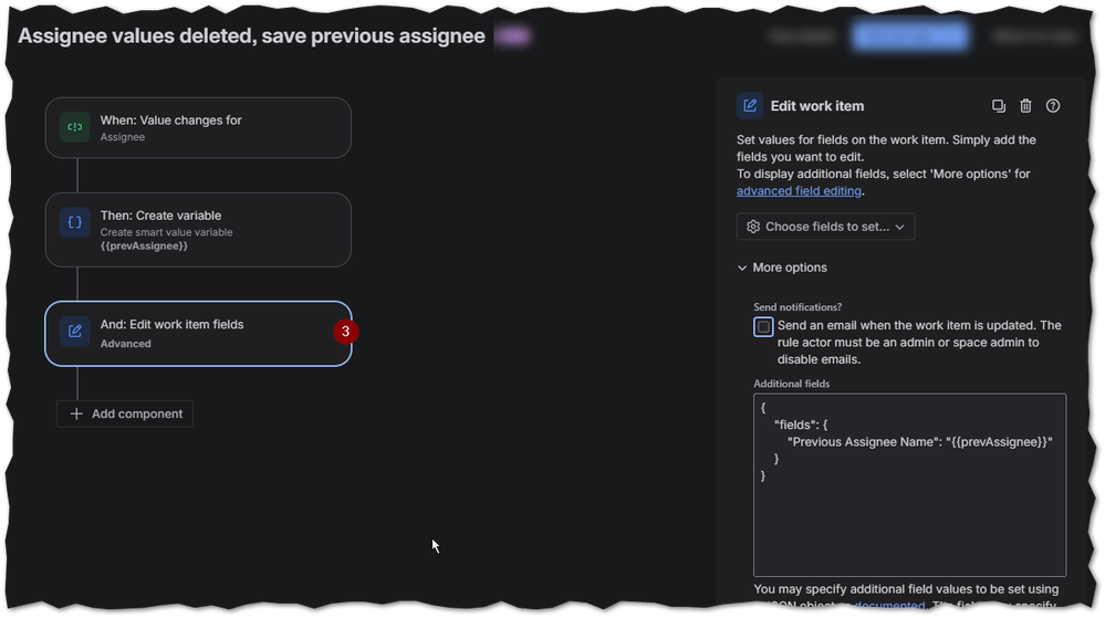

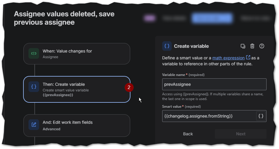

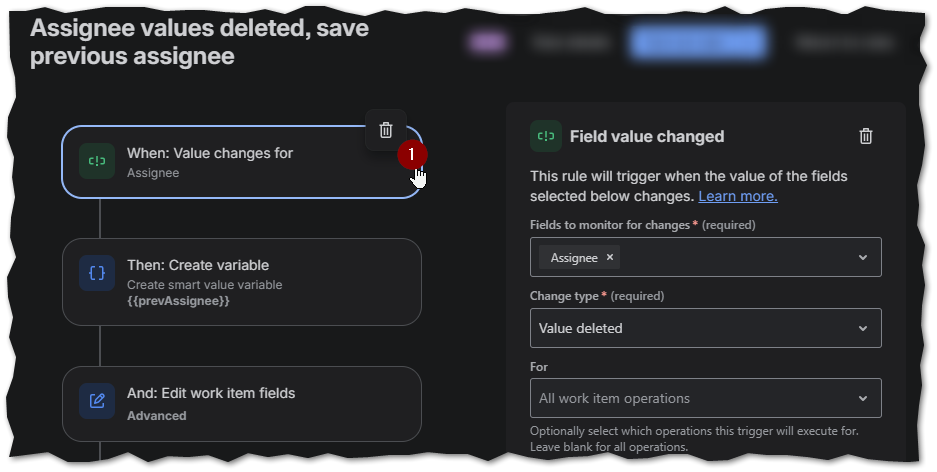

Niklas Malmberg
January 20, 2026
Found this thread today and it helped me to implement this in our system. Many thanks to @Bill Sheboy and other contributors.
Here's a concise solution for a Team-managed Jira software project if anyone would like to copy it:
Step 0: I created a custom field 'Previous Assignee Name' in my project.
Then, I created this rule with 3 steps:
Screenshot 2026-01-20_000794.pngScreenshot 2026-01-20_000795.pngScreenshot 2026-01-20_000796.png
Notes:
1. Although I only use the trigger when Assignee field is _deleted_, it works just fine also when one name is replaced with another too, not just changed to [unassigned] (=delete)
2. fromString returns here the user display name which can be used at once
