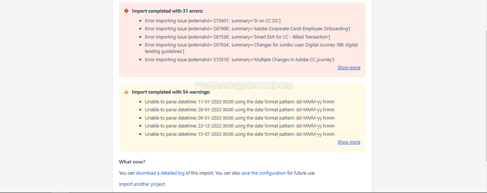

1 projects and 0 issues imported successfully!
Import completed with 100 errors:
  • Error importing issue [externalId='autoid-3193429464196132252', summary='Internal Pre and PRD consoles should be restricted to jumphost. But can be accessed by desktops']
  • Error importing issue [externalId='autoid-3595183157424957155', summary='corpregistry has an ejb injection in all environments']
  • Error importing issue [externalId='autoid-2241411063412407852', summary='corpregistry only needs one server running in the cluster']
  • Error importing issue [externalId='autoid-8673940725337750076', summary='client IP not being passed into logs']
  • Error importing issue [externalId='autoid-337310478029586513', summary='need splunk dashboard for PRD']

Conic Lu
May 20, 2024
Hi!
It doesn´t work to me :(
