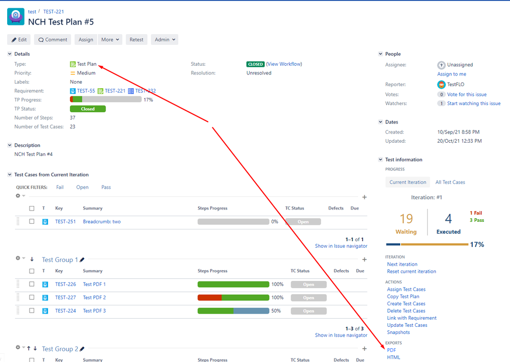

Nina Zaradniak_Deviniti_
Atlassian Partner
January 18, 2022
Hi!
I think TestFLO Test Management for Jira could meet your needs. In TestFLO, you can export each Test Plan (executed or not) with all Test Cases by using the Export to PDF option. You can also decide which fields will be added to your file. You can find more information in our documentation.
Best,
Nina.
Radoslaw Cichocki {Deviniti}
Atlassian Partner
January 19, 2022
That's exactly right.
You can give it a try here:
http://demo.testflo.com/server/browse/TEST-221
login/pass: testflo
jean gan
January 20, 2022
Is word document supported?
Atlassian Partner
January 26, 2022
Yes, you can also export the Test Plan as a Word document.
