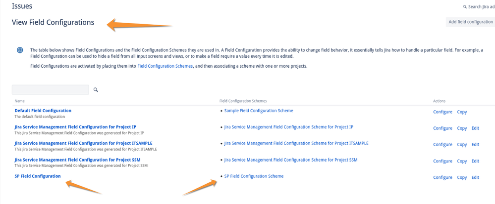

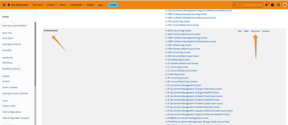

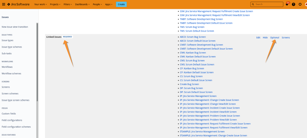

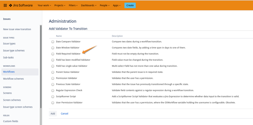

Hi @Kapil Podduturi To make a field required on particular screen, the recommended approach is to use to workflow validators to make the field required.
If you want to make it required for your entire project, you can make it required in field configuration like the one you created above.
If you make a field required in the new field configuration you created "Test Field Configuration" the filed will be required for the projects which are currently using it even it is showing that field is used in many screens.
Make sure that the field configuration you created is not used in any other projects.

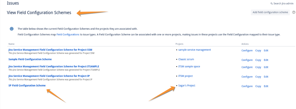

Also, create a new Field Configuration Scheme and associate your Field Configuration to it and then Associate that Field Configuration Scheme to your Project.
Please find the below screenshots for more details :
