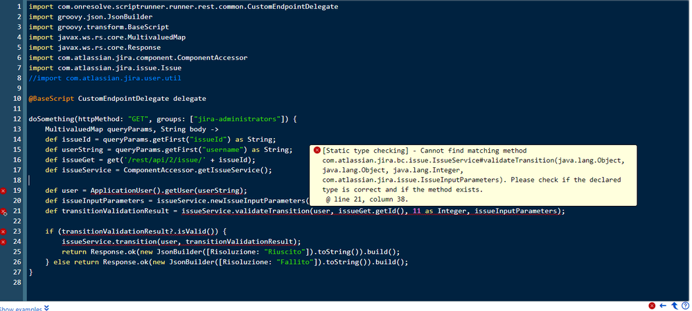

Stefano Rosario Aruta
February 15, 2019
Marc Minten (EVS)
February 15, 2019
These are just static type checks. You can ignore them.
Groovy does run time type checking, and this will run correctly.
If you would get rid of these errors, you should declere your variables with the corerct type:
ApplicationUser user = ...
