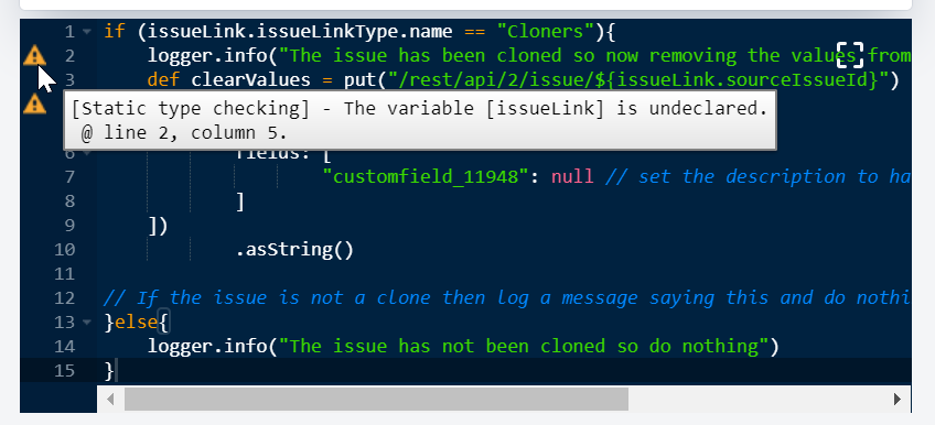

Suresh Bhandiwad
September 16, 2019
Thank you for your response Kristian!
I see below static error when configured and ended in failure. IssueLink not declared.  Is there something I need to add further?
Attached screenshot.
Kristian Walker _Adaptavist_
September 17, 2019
Hi Suresh,
Can I please ask you to confirm if you set your Script Listener to be configured on the IssueLink Created event as the listener will need to be configured on this event in order for the issueLink variable to be available to the script.
I can confirm that if you use the Issue Created event which is similar that you will get this static type checking warning and that you should change the event to be the  IssueLink Created event to resolve this warning.
Regards,
Kristian
Like Darren Xie likes this
Suresh Bhandiwad
September 17, 2019
Hi Kristian,
It worked like a charm!
Yes, you're correct. I configured for Issue Created which caused static type checking warning ending up in failure. Changing the Event to IssueLink Created resolved issue.
Thank you so much!

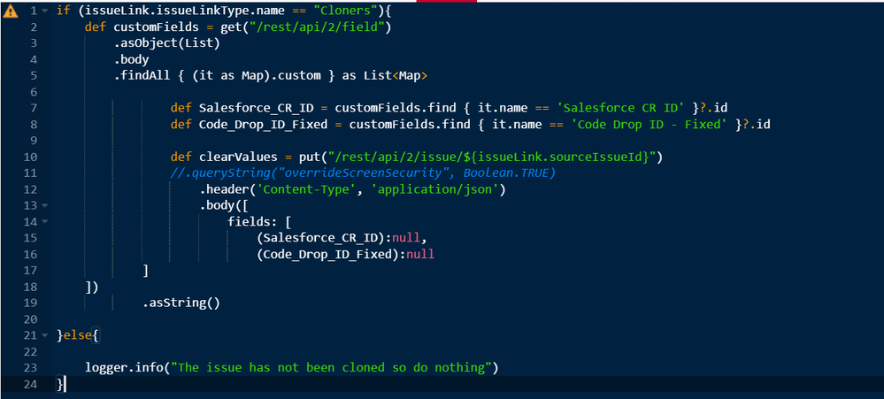

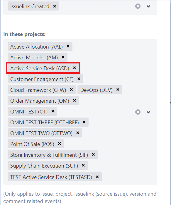

Suresh Bhandiwad
January 18, 2021
Hi Kristian,
Yes, you're correct. It is configured correctly however we are passing two fields to clear the values simultaneously. Since, the other field failes whole script terminates with failure. Thank you for the quick response.
Thanks,
Suresh

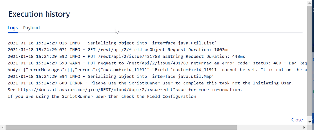

Suresh Bhandiwad
January 18, 2021
Hi Kristian,
Please find the attached screenshots & they as below:
Config - 01: Shows the projects and events its configured
Script - Its the same script you had shared earlier
History - Shows all were successful
Execution History shows some logs
Salesforce CR ID: customfield_11950
Code Drop ID - Fixed: customfield_11911
2021-01-18 15:24:29.016 INFO - Serializing object into 'interface java.util.List'
2021-01-18 15:24:29.071 INFO - GET /rest/api/2/field asObject Request Duration: 1002ms
2021-01-18 15:24:29.592 INFO - PUT /rest/api/2/issue/431783 asString Request Duration: 443ms
2021-01-18 15:24:29.593 WARN - PUT request to /rest/api/2/issue/431783 returned an error code: status: 400 - Bad Request
body: {"errorMessages":[],"errors":{"customfield_11911":"Field 'customfield_11911' cannot be set. It is not on the appropriate screen, or unknown."}}
2021-01-18 15:24:29.594 INFO - Serializing object into 'interface java.util.Map'
2021-01-18 15:24:29.609 ERROR - Please use the ScriptRunner user to complete this task not the Initiating User.
See https://docs.atlassian.com/jira/REST/cloud/#api/2/issue-editIssue for more information.
If you are using the ScriptRunner user then check the Field Configuration{code:xml}
How we can fix this while passing two custom fields to clear their values.
Thanks,
Sures2021-01-18 23_02_05-Script Listeners-Jira.pngConfig-01.pngHistory.pngScript.png
January 18, 2021
Hi Suresh,
I can confirm that your error shows that the custom field with the ID of customfield_11911 is not on the edit screen and due to this the value cannot be cleared as the plugin can only clear values when the field exists on the edit screen.
As the error says to make the script work for fields not on the edit screen you need to uncomment line 11 and then change the script listener to run as the ScriptRunner add on User as this will then allow it to set the value of fields which are not on the edit screen.

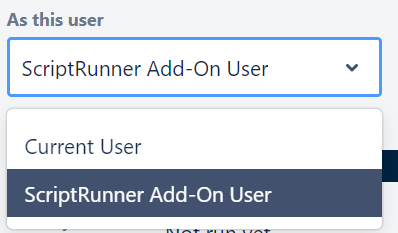

Suresh Bhandiwad
January 19, 2021
Hi Kristian,
As advised, I uncommented line 11 & choosed Add-On user. I am not finding the way to give add-on user required permission.
{"errorMaessages":["Only Connect add-on users with admin scope permission are allowed to override screen security."],"errors":{}}
How we can give this permission to ScriptRunner Add-On User?
I do not find a way to do at global level. Can you please guide me?
Thanks,
January 19, 2021
Hi Suresh,
Can you please confirm that you saved the script with line 11 uncommented and the As this User box set to the ScriptRunner Add-On User.
After this all new events which trigger the listener should then be able to update the field which is not on the screen.
If this does not work then can you please provide a screenshot showing how you have configured the script to add in these changes.
Regards,
Kristian
Suresh Bhandiwad
January 19, 2021
Hi Kristian,
Seriously, I am not sure what went wrong. Just saved the content once again & it worked.
Thanks,
Suresh
