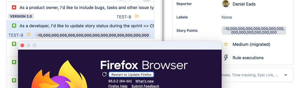

Interestingly enough, I was able to get -1e40 onto an issue as well:
But it didn't crash Firefox 95.0.2 on my test.

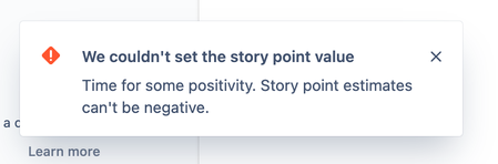

However, using the new issue view (the only view possible on the backlog, and the default for viewing issues normally), the validator will stop you from creating negative story point values.
As the new issue view is rolling out out all sites and is now the default for most users , I think we can say "it has been fixed".
