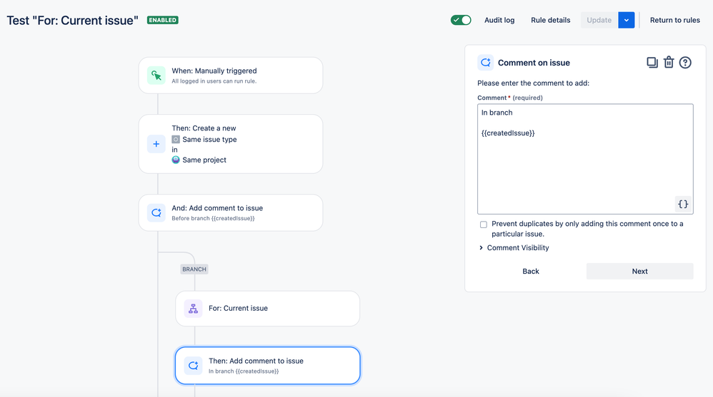

To me it seems that both examples do exactly the same so I don't see the real example when to use the branch "For: Current issue" could be useful.

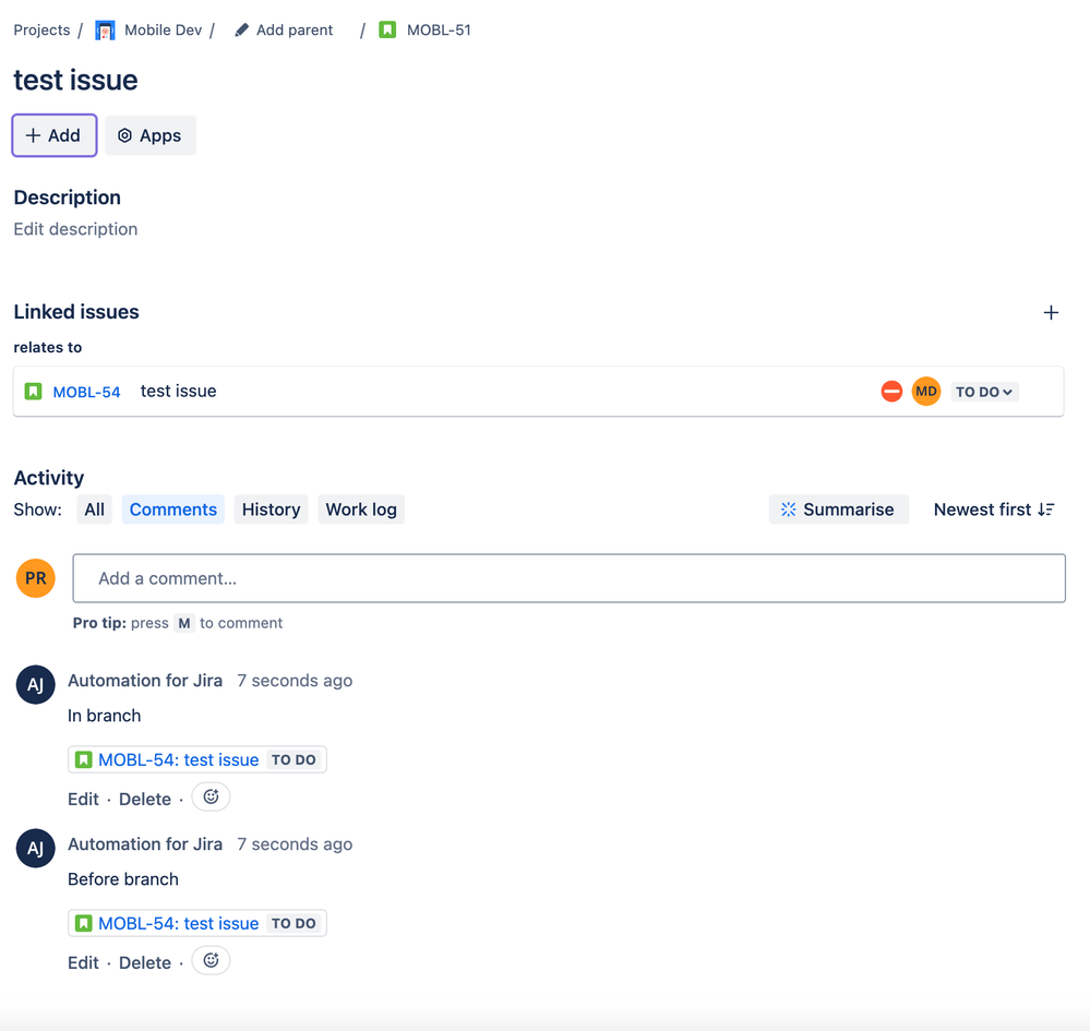

I've made this example Automation rule and you can see that both comments are placed in the same issue.
If I wanted to have a comment being added in the created issue, I could branch over the newly created issue(s).
So my question is, do you have examples when you're using the "For: Current issue" to solve something that's not possible otherwise?

One of the only use cases I know for the Current Issue branch (recently renamed Current Work Item) is using conditions AND continuing with the rule flow in step-order rather than halting.  The reason that works is branches on one-and-only-one thing are executed sequentially (as if the branch did not exist), as compared to other branch types which run in parallel and asynchronously.
For example, one case is repeatedly updating the same work item for different conditions:
  • trigger: some trigger which returns 1-to-many work items
  • related issues branch: Current Work Item
    • condition: test something
    • action: perform some action to the work item
    • action: Re-fetch Work Item Data
    • condition: test something else
    • action: perform some other action to the work item
Without those branches, the rule would halt as soon as it reached the first condition which did not pass.
Regarding that article's explanation of {{triggerIssue}} versus {{issue}} (i.e., "current issue"), this is a matter of scoping: {{triggerIssue}} is always the same and {{issue}} changes based on where you are in the rule when {{issue}} can change when inside of a branch over work items.
  • trigger: some trigger that returns a work item -- At this point, {{triggerIssue}} and {{issue}} are the same.
  • action: some action -- At this point, {{triggerIssue}} and {{issue}} are the same.
  • branch: to some work items (e.g. on JQL returning more than one issue) -- At this point, {{triggerIssue}} and {{issue}} are the same.
    • action: another action -- At this point, {{triggerIssue}} and {{issue}} are different, where {{issue}} changes as the branch loops
  • action: some action after the branch -- At this point, {{triggerIssue}} and {{issue}} are the same again
