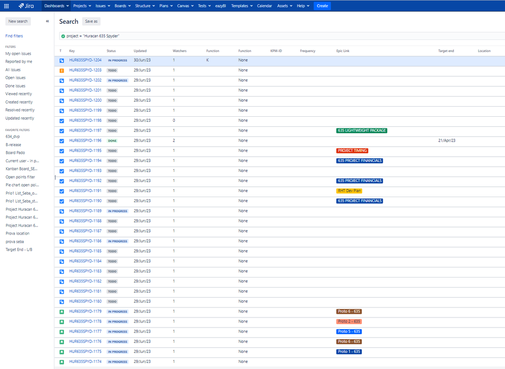

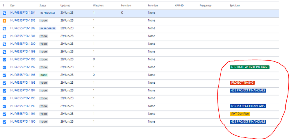

In the Issues Search view I can highlight the Epic Link as a column in the visualization.
Is there a similar "field/column" where I can view the name of the (parent) Task when I visualize the sub-tasks?
See the image attached for an explanation.
Thanks
Like # people like this

Can you share a screenshot of that full page from above? So I can see what is in the left hand side.
Amedeo
June 30, 2023
Like John Funk likes this
John Funk
June 30, 2023
Ah, definitely not Cloud then. And here is another post in which the user also cannot add the Parent field.
