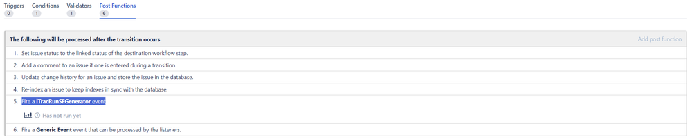

I would like an event to be fired when a transition is executed.

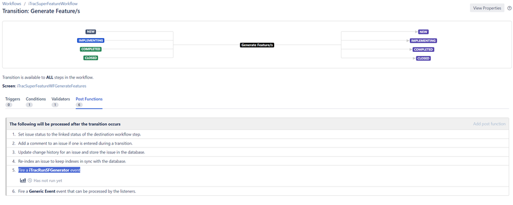

Here is the whole picture
The transition is still shown as inactive even though it is used by a workflow:
How can I fix this problem and make the transition valid?
The event is also not fired when I click on the transition enter image description here

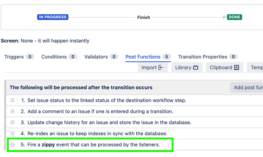

For me, to get this to recognize the workflow post-function, I had to fire the event from the existing post-function, like so:
and to satisfy the need for it to be "associated with a workflow", create a dummy workflow used by no projects. In the dummy workflow, change the default post-function make a reference to your event.
Once you do, your events suddenly become active.
Once active, you can fire them via a post-function or in custom code.

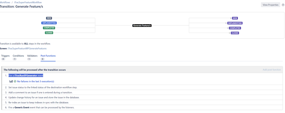

Mouna Hammoudi
October 12, 2023
@Nic Brough -Adaptavist-
I have triggered the event many times, here is the proof
However, the iTrac SF is still inactive
October 12, 2023
So it is active.  What makes you think it is inactive?
