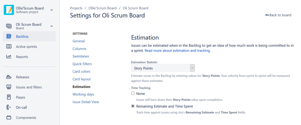

The migration should not affect the original story point estimates. It is recommended that you check from the following aspects.
1.board settings -->Estimation

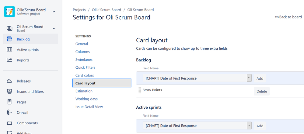

2.board settings -->Card layout

I checked all the above. Estimation and project settings are done right; story points are added and checked. However, the card layout doesn't seem to have this nor am I able to add it in. The list doesn't show story points
So you can find the story point field in the Screens scheme, but can’t find it in the card layout set in the board?

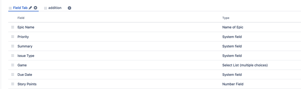

But we do have story points in screens scheme (screenshot attached)
It's just the card layout section that doesn't show story points.

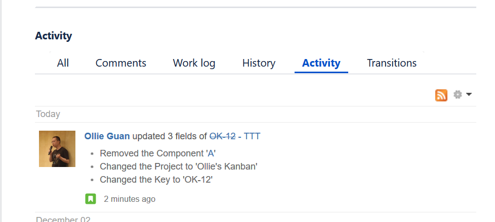

I noticed that the story point field type of the screenshot above is a Number Field, which does not look like the original story point field of the System Field, but a custom field with the same name.
After the issues migration is completed, the changed information will be recorded in the issue's Activity, such as project name, key, etc.
Can you check if the fields of the story point have changed?
Yikes, yes! The activity says I removed the story points :/ Not sure how that happened.
