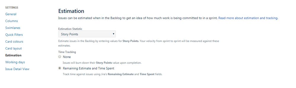

Go to Board > Configure then click the Estimation tab
Change the Estimation Statistics from Story Points to Original Time Estimate, then the Remaining Estimate and Time Spent radio button

Click "..." ->Board Settings
Click Estimation in nav bar
Make adjustments mentioned above

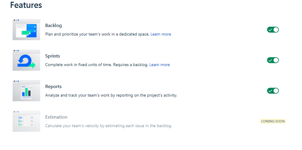

Hi, I do not see any Board->configure either. i dont see story points field though i am able to configure it. my sprint is also on going.
i am the Admin to the project and just created the link and new project. i am currently on a free trial for 7 days.
also shows me that estimation feature is coming soon.  please help.

You're using an "Agility" board, which doesn't have the Board -> Config that Scrum and Kanban boards get.
Erika Sa
June 25, 2018
Hi @Neha Damania
Currently agility project doesn't support estimation. However, as indicated on features page, it is coming soon (specifically, story pointing). In the meantime, you can create a new project called "scrum project" and follow above-mentioned direction to try out estimation in your evaluation period.

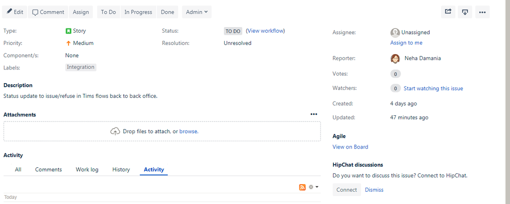

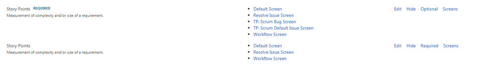

Thanks Nic and @Erika Sa  for your help. i have now created a new scrum project. and done the required configuration from Board settings -> estimation. and in filed configuration as well story points is configured to be on 3 screens. but i am still unable to see the estimation/story points field on the stories.
When i try to start the sprint, it says "tickets do not have a value for the 'Estimate' field. Values entered after the start of the sprint will be treated as scope change." please help.
Nic Brough -Adaptavist-
June 26, 2018
The easiest way to find and fix this one is to click "edit" and then use "where is my field" under the "configure fields" at the top right.  That will walk you through all the possible reasons the estimate is missing.  Ask it about the "time tracking" field.
The reason it is warning you about empty estimates is that in Scrum, you commit to doing a set of pieces of work who's estimates fit within what you think you can achieve.  Without estimates going into a sprint, you can't measure that.
Neha Damania
June 26, 2018
yey !! thanks tons. I did go to the "where is my field" yesterday as it is pretty intuitive but did not scorll down in the pop up where it suggested config change :(. all good now :) thanks again.

Douglas Beckett
August 21, 2018
