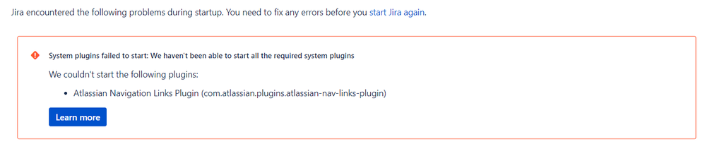

Problem:
After configuring the database connection jira proceeds to start up, but everytime fails with
I did try the solutions proposed in https://confluence.atlassian.com/jirakb/troubleshooting-jira-startup-failed-error-394464512.html, without luck. Almost every solution proposed that I found was setting:
-Datlassian.plugins.enable.wait=300I tried to changed to a higher number and to a lower without success.
I did also try to increase the maximun running processes following this link https://confluence.atlassian.com/jirakb/jira-applications-crash-due-to-outofmemoryerror-unable-to-create-new-native-thread-224397455.html because when running jira in foreground, while starting the plugins an OutOfMemoryError ocurred.
I don't know what else to try.
