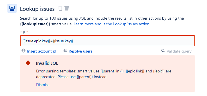

I try to list all stories of an epic using lookup issues, and I use the following query
But it fails... and {{parent}} doesn't work :/
Any idea how I can do that?

Try replacing the {{issue.epic.key}} with {{issue.parent.key}}
so that it looks like
{{issue.parent.key}}={{issue.key}}
which should be similar to
"Parent"={{issue.key}}

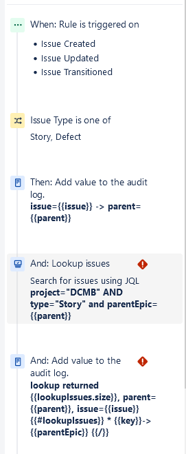

For automation rules, triggerIssue is to be used. If you can share information regarding what you are using for the trigger on your rule, this may help define what set issues the lookup component/action is collecting.
This is what I use. Everything that has Epic in it is refused. But the problem is that for my stories, the parent/epic information is stored in parentEpic, not in parent. No idea why.
If I dump {{issue.parent.key}} for my triggered story, it gives me the right value, as well as {{parent}}
issue={{issue}}, parent={{parent}}, pkey={{issue.parent.key}}
issue=DCMB-2491, parent=DCMB-1482, pkey=DCMB-1482

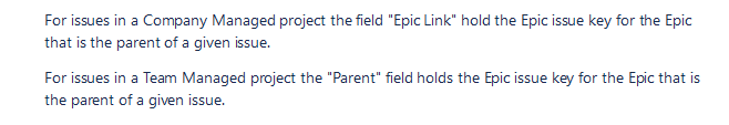

I found some info here : https://community.atlassian.com/t5/Jira-questions/Jira-Cloud-issuefunction-how-do-i-get-the-Parent-Key/qaq-p/2153077
So that would mean I'm on a Company managed project. Why would there be a difference between the 2 ?

I did a lookup just on type='Story', it returns me 100 values, and I dump the parent for each one in logs, they are all empty.
When I use the issue navitagor with a JQL query, I use parentEpic as a key to filter by parent. If I use parent, it is empty.
But I cannot use parentEpic in automation.
