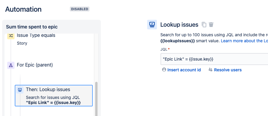

Here I've my approach on using lookupIssues to do the sum of story points in an Epic. But looks like LookupIssues ins't able to get the values of story points.
Am I missing something here? Can someone suggest how to improve on this?
Hello @Sanjog Sigdel
To use the {{lookupIssues}} smart value you must first use the Lookup Issues action.

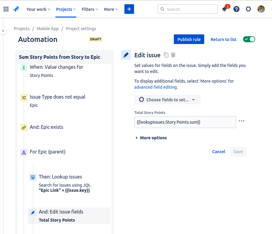

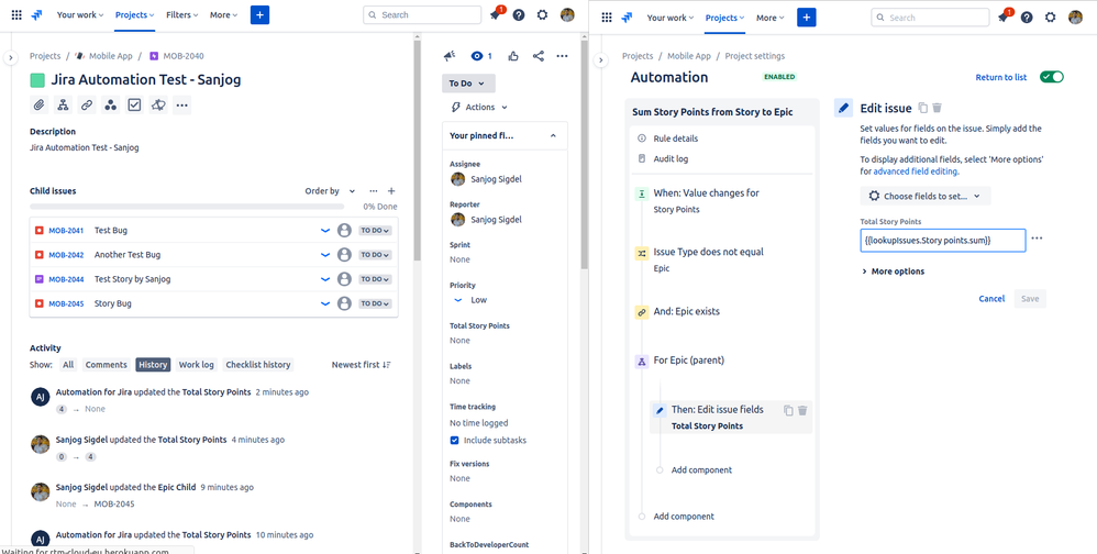

This actually worked Thanks a lot @Trudy P Claspill .
For future reference: I added the Look Issues like Mentioned above and then updated the Edit issue fields, Total Story Points like below:

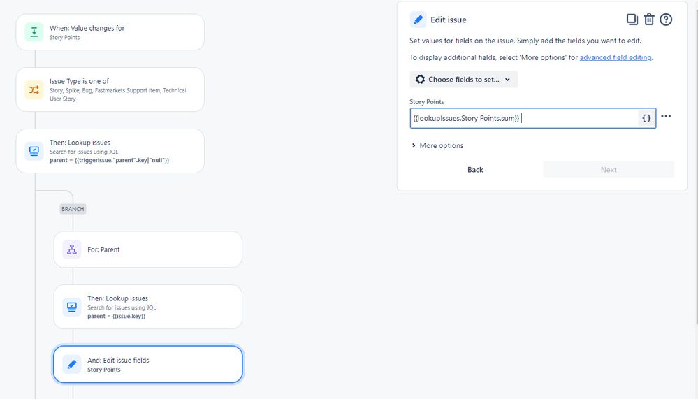

Hello Community,
has somebody managed to make this Automation in JIRA Cloud with the Parent changes from Epic link? I am struggling and getting only 0 and I am just int he begining of creating the full automation rule to cover the scenarios:
1. When new child is added
2. when parent is changed
3. when item is cancelled
4. Wen estimation changes...
Thanks in advance

An additional debugging tip is to use the Log action to print out the number of issues found by the Lookup Issues action using the smart value {{lookupIssues size}}
