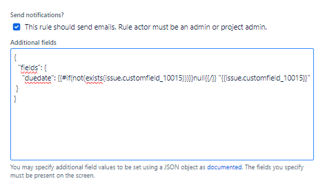

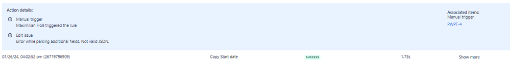

And when the customfield_10015 is not empty then it works, but when the customfield is empty I still run in an error.

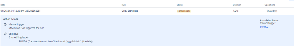

"duedate": {{#if(issue.customfield_10015.isEmpty)}}null{{/}}"{{issue.customfield_10015}}"
Same behaviour. It works when customfield_10015 is not empty, but it runs in an error when customfield_10015 is Empty:
image.pngIt seems like the condition does not work

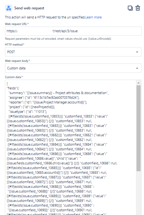

I am using a rule in order to create automatically a Jira project by using Rest API.
In the same automation I use additional Web requests to create specific issues, filters and boards in the new created project ({{newProjectID}}.
Next to mandatory attributes like "summary, Reporter, issuetype etc. I want also to update optional fields like customfield_10853 from triggerissue to new Issue which should be created by the Web request.
But the web request is only successful when the triggerissue has data in all defined custom fields. I was expecting that when the value of customfield_10853 in triggerissue is null then the customfield_10853 in the new issue should be also null. But that does not work. JSON is expecting a value.
So i tried to use conditional logic within the JSON code but it works only sometimes. For better testing I tried to test my Code logic with a more simple example like above.

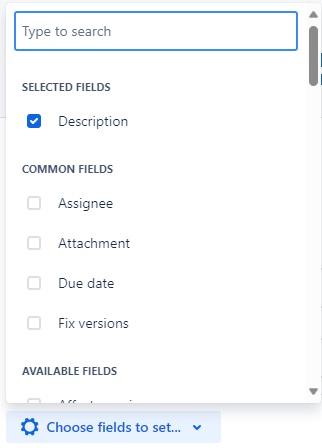

You don't need the "More fields" section to copy the due date from the trigger issue. Just select it in the "Choose fields to set" and put the smart value directly into there.
See if that works.
