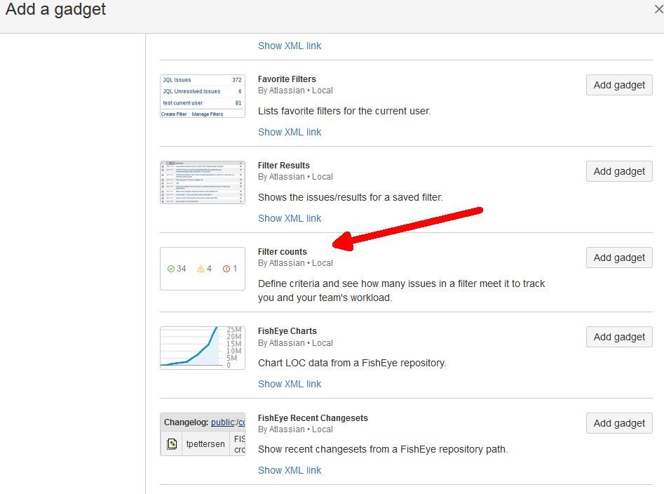

I get the following error message when trying to add the 'Filter counts' gadget to a dashboard:
'Unknown error occured initializing this gadget'
Does anyone know how to fix this?

The gadget is signed with 'By Atlassian • Local', so I assumed it's a standard Jira gadget and not made by an external provider.
We use Jira in the Cloud so I don't think I have acces to any logs unfortunately.

Ok.  I don't recognise "filter counts" as a standard Atlassian gadget - could you give us the actual name of it?
Marco Hendrikse
August 21, 2017
That is the actual name:
