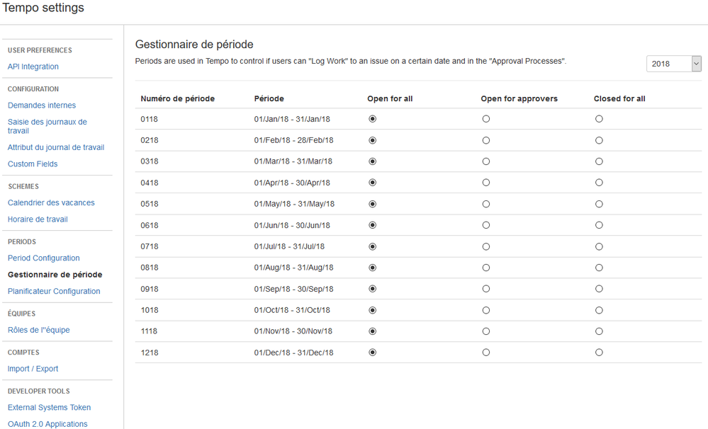

In tempo settings / Period management All period are open to ALL.

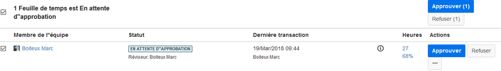

Yes there is an approval pending on this timesheet.
I'm my Timesheet revisor so I tried to appove my timesheet but it didTempoApprovalPending.PNG not work. I tried to refuse also but the timesheet status remains "waiting for approval"
