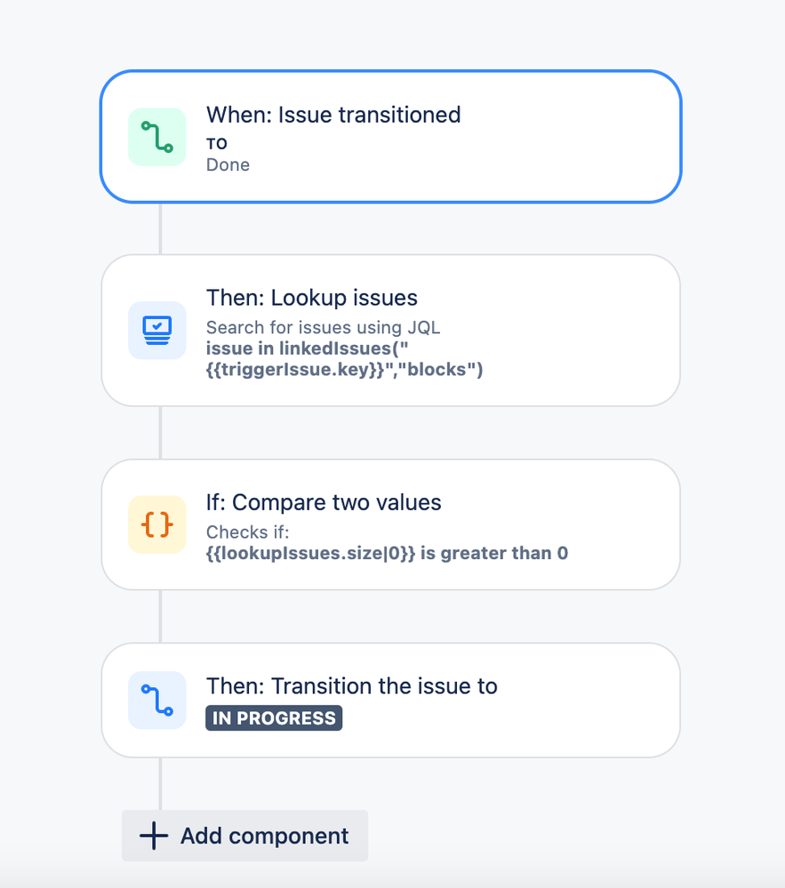

The solution depends on two things:
1. The way you link dependent issues.
2. The way, in the rule, you are looking for dependent issues.
When you set an issue as dependent on another issue, I assume you are using the issue linking functionality.
An issue link has a name, and Inward Description, and an Outward Description.
If you look at the issue that has been transitioned to Done, and you look in the Issue Links section, you should see a Description header above the dependent issues, for example "is depended on by" or "blocks".
If you open one of those depended issues and look at its Issue Links section you should likewise see a Description header above a list that includes the issue that you changed to Done. The header may be something like "depends on" or "is blocked by".
If the same Description appears in both the primary and secondary issues' Issue Links section, that could be the cause of the problem.
If the Description is the same as the Name of the link type, that could be the cause of the problem.
To find dependent issues in your rule you might be using a Lookup Issues action with a JQL that includes the linkedIssues() function:
https://support.atlassian.com/jira-software-cloud/docs/jql-functions/#linkedIssues--
...such as
issue in linkedIssues("{{triggerIssue.key}}","is depended on by") and statusCategory !=Done
The linkedIssues function should find the issues linked to the trigger issue with the specified link relationship.
You can then check if the Lookup Issues action found more than 0 issues. If it did, then you transition the trigger issue back to In Progress.
If you have not tried a rule structured like that, please consider trying that and see if it resolves your issue.
