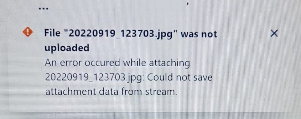

Bryan.Lumije
September 20, 2022

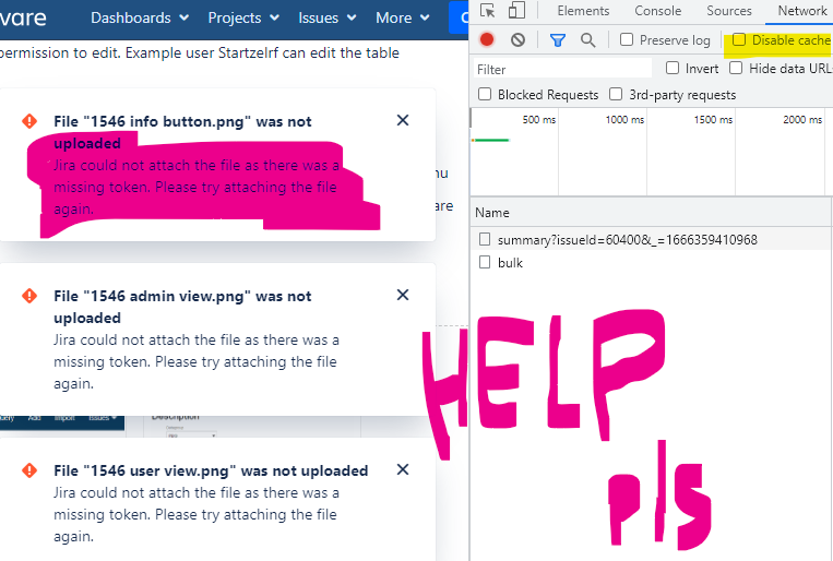

George Pistachio
October 21, 2022
I also have the same issue and made sure to check Developer Tools to see Disable Cache was not checked, restarted chrome, cleared cache, logged out and logged in. Is this issue fixed yet?
