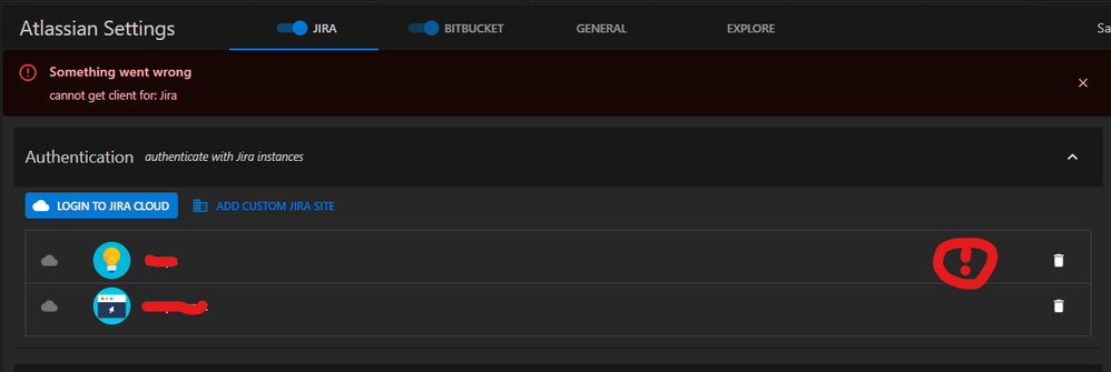

Kristian ASK
August 5, 2024
In the settings for the Atlassian extension there is a collapsed section called Authentication. Expand that and click the little exclamation mark icon. It will take you to the site where you need to update the authorization.
mawi
August 16, 2024
The odd thing is, in my case, I do not see any exclamation mark.

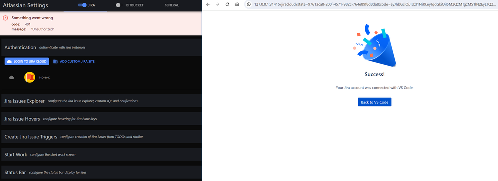

August 23, 2024
Tried again today. Got a 401 (new message), oddly enough.
One window says "Success!" (auth flow), the other then says "Unauthorized".
And ofc, no logs or anything further to understand the issue.

Aleksei.Baranov
June 11, 2024
Still have the same issue with Jira. I read all comments here and tryed the most complicated.
After unauth+auth+close window before Back button+click Back to VSCode I get another error ;)))
Something went wrong
code:401
message:"Unauthorized"
