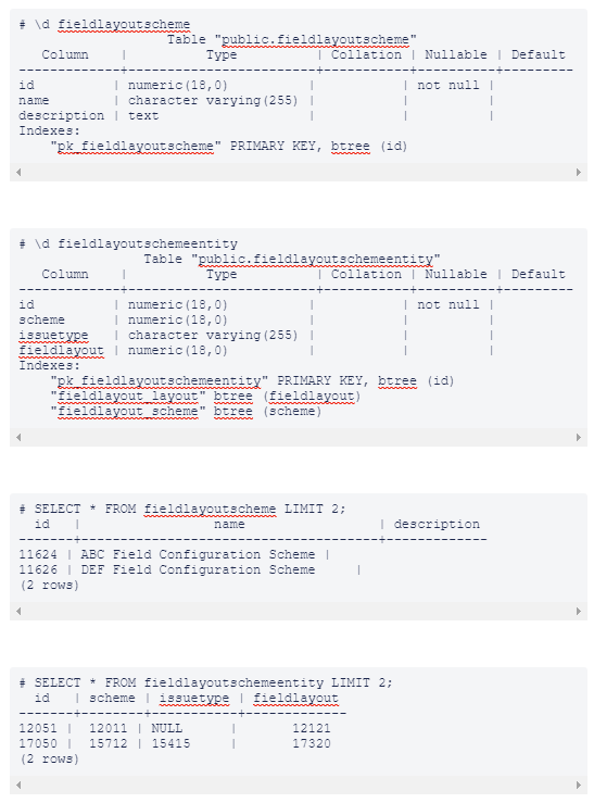

Some examples what I see locally, where you see the relationship between fieldlayoutschemeentity.scheme <> fieldlayoutscheme.id
And I have to paste this as img because form validation here is borderline useless:
