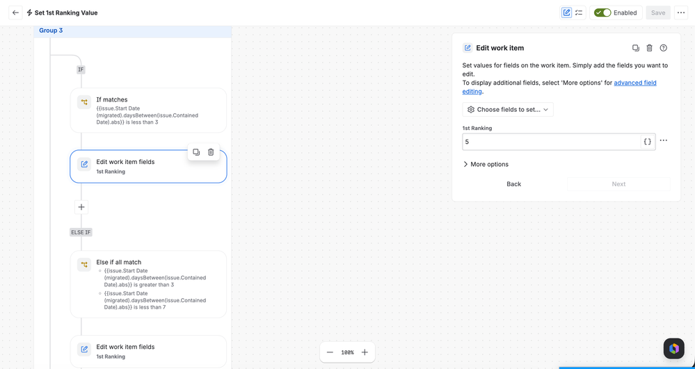

Hi everyone,
I set a automation rule to compare value between 2 date picker field, if it's less than 3 days, then set another field value to 5, if between 3 and 7 days, set to 4, etc.
Here is the smart value I put in {{issue.Start Date (migrated).daysBetween(issue.Contained Date).abs}}

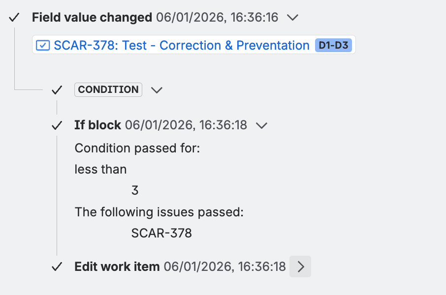

However, no matter what dates I pick, it all passed first if block (less than 3)
Unable to resolve this even I tried solutions that provided by AI, anyone can help?
Screenshot 2026-06-01 at 4.44.58 PM.pngScreenshot 2026-06-01 at 4.45.45 PM.png
Thanks in advanced
Jack

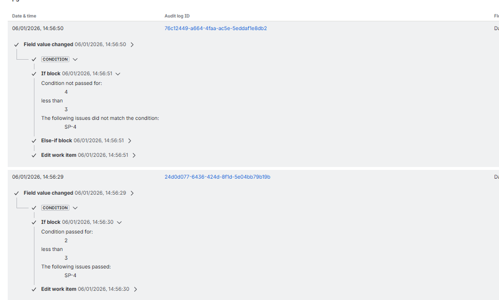

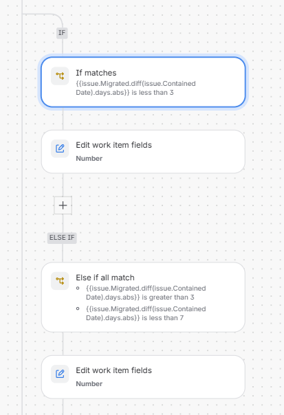

Hi @Jack Yang ,
Replace the smart value with:
{{issue.migrated.diff(issue.Contained Date).days.abs}}
and keep the rest of the automation unchanged.
This worked successfully in my instance. I've attached a screenshot below for reference.
Jack Yang
June 1, 2026
Thanks @Yashaswini YK for your quick response, it works properly now, thanks again for your help.
