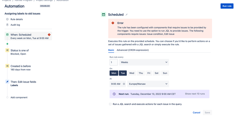

I want to automate assigning labels to old issues in my backlog so that I can then filter them out easily and keep the backlog fairly clean. I'd like all issues older than 180 days from the date of the scheduled rule execution to have the defined label added.
I'm using Jira Automation and using scheduling as a trigger seems the best possible scenario.
I provide the following components( see attached screenshot):
  • `status=one of blocked, open`
  • `created is before 180 days from now` Screenshot 2022-12-12 at 14.57.50.png
  However, when I try to launch the automation,  the following error occurs:
> The rule has been configured with components that require issues to be provided by the trigger. You need to use the option to run JQL to provide issues. The following components require issues: Issue condition, Edit issue
Do you have any idea how the JQL search should be launched and what are the required issues mentioned in the error description --> `Issue condition`, `Edit issue`?
Thank you!

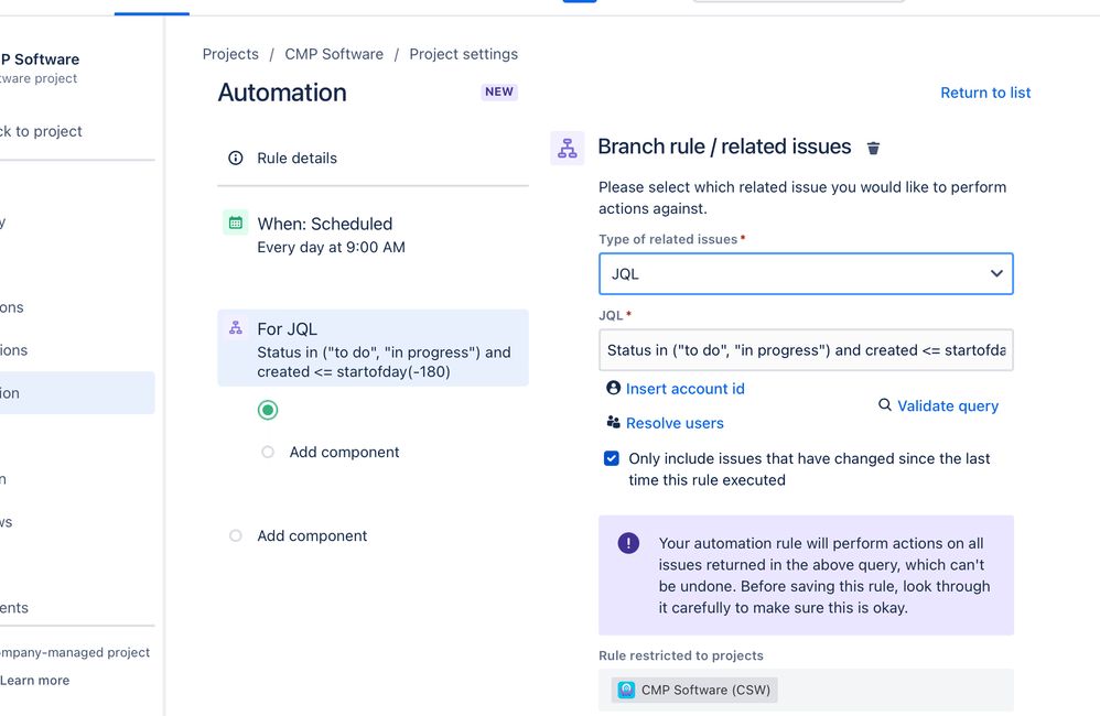

Jack Brickey
December 12, 2022
Hi @Pawel Halas , try replacing your two conditions with the branch as shown below...

Maksim Marholin
December 12, 2022
Hi @Pawel Halas,
some explanation first:
  • you are using scheduled trigger, which by itself doesn't return any issues (while other triggers usually have some issues)
  • however, you also use branches and action, which needs some issues to operate on
  • as a result of that you get an error telling you your trigger must return some issues for your branches and action to work
in your screenshot there is a check box at the bottom saying "Run a JQL search and execute..."
If you check it, you will be provided with a JQL input to filter your issues. As suggested in the comments above it is a good idea to merge both your branches into this JQL.
Hope that helps.
