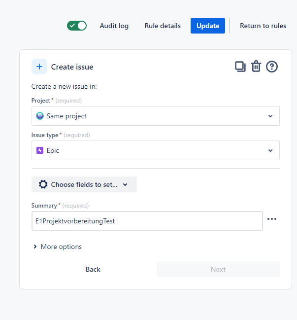

Hi there,
getting the above mentioned error by creating Epics in an automation rule. Setting up an Initiative firing a custom field "Projecttype" the rule should create the Epic (and underneath later Stories and tasks).
Here is the rule:
It's confusing, because the the rules went  super before. Many thanks for any help!

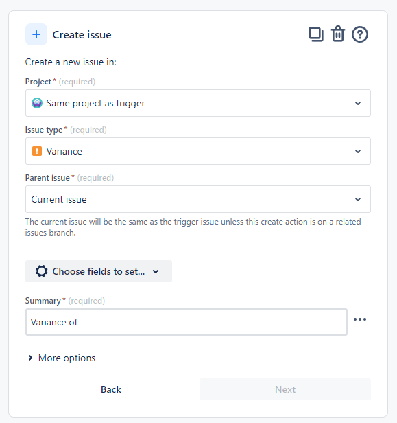

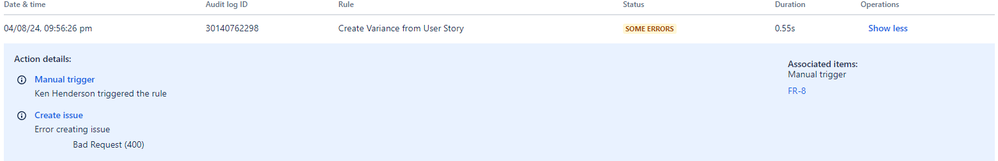

I have the same challenge here. Below are snapshots of the logs and configuration. I don't have any required fields on this subtask type, as it can easily be added via the sub-task "+" on the parent story. Any thoughts or guidance are very welcome! Thank you!

It is definitely about a field. We have the same issue, there was an automation rule that used to be working but stopped recently. When I looked into it, I saw that the engineering team added a new mandatory field. mapping it solves the issue.

Hi Olaf,
Without using an automation, check to see if there are any fields you must fill out to create a new Epic in your l1_Entwicklungsprojekt project when creating an Epic manually via [Create] Jira button.
If there are any required fields, those fields must also be filled out when creating a new Epic via automation.
When this mismatch happens you'll see Error creating issue Bad Request (400) as an error in your automation audit log.

Can you try to manually create the epic with the summary only?
