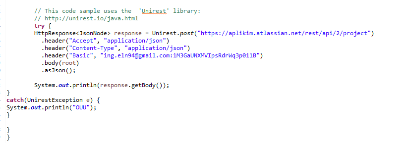

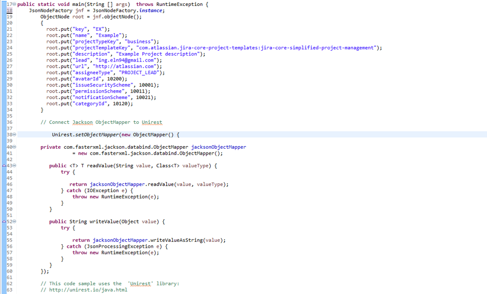

Hello,

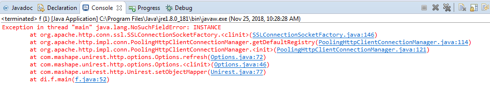

I am trying to create a new project in Jira cloud using Java Jira Rest API but it gives me an error: Exception in thread "main" java.lang.NoSuchFieldError: INSTANCE.

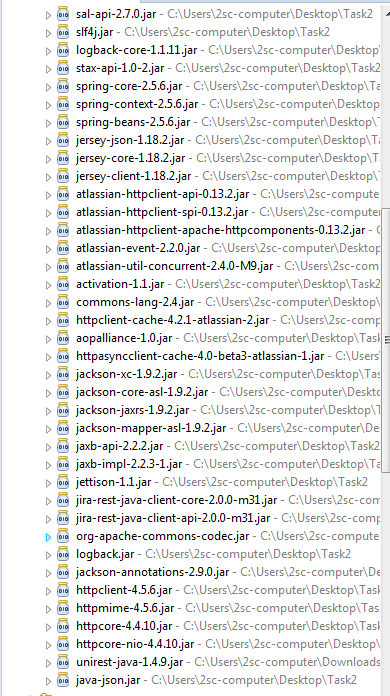

I have removed the older versions of http client from my classpath but nothing changes.
Can anyone help me to find out where is the problem or any other sample code that works for create a new project in jira?
Note: I have used Basic Authentication:
Username: My email adress
Pasword: My Jira account pasword
In the attach there are the code that I have used, the error it produces and the jars.jars.PNG

Your code is feeding your Jira instance a field that does not exist.  Try not sending that pointlessly, it should work fine then.

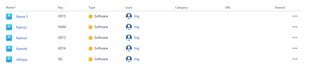

For example, as shown in the image I have created some projects and I am the leader.
When I use : \"lead\": \"Ing\"  it gives me the same error

But "Ing" is the admin and when I create a project manually by using the Create New Project button in Jira it creates succesfully. I want to use Java code because I want to create multiple projects. So where is the problem?
Nic Brough -Adaptavist-
November 25, 2018
The problem is that you're not giving it a valid user for the project lead.
