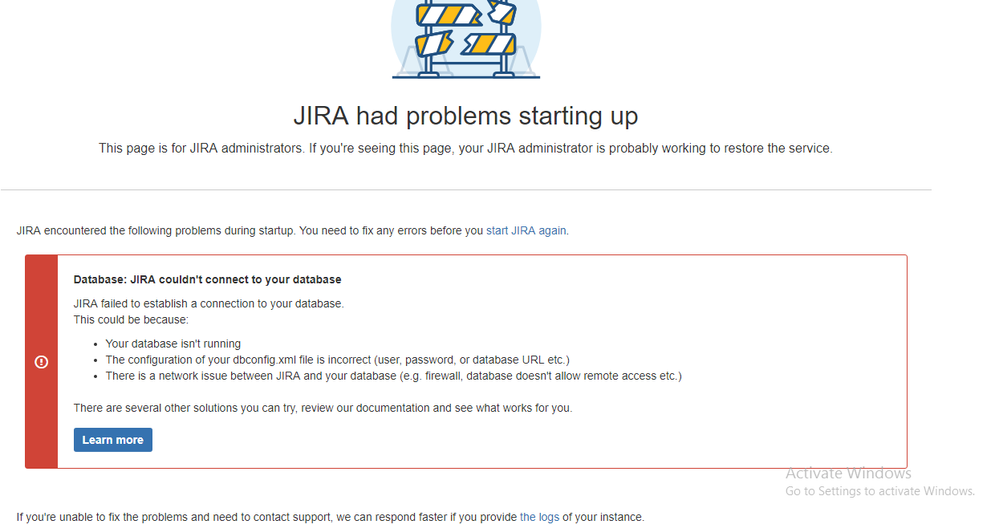

I have installed Jira instance on server VM machine in Jan 2018.  I am using Jira since January 2018 for project tracking purpose. settings as per follow.
1. Configured in built database.
If I navigate to Jira URL it shows me database connection error message.
Please suggest workaround.

Yogesh Mude
August 20, 2018
HI @kapil kinikar
Could you please share with us error message or screenshot for the same.
kapil kinikar
August 20, 2018
Sure, Please see attached screenshot
Yogesh Mude
August 20, 2018
HI @kapil kinikar
As mentioned in the error screenshot please check whether the Database is running or not and the confirm that have you been provided database details are correct?
