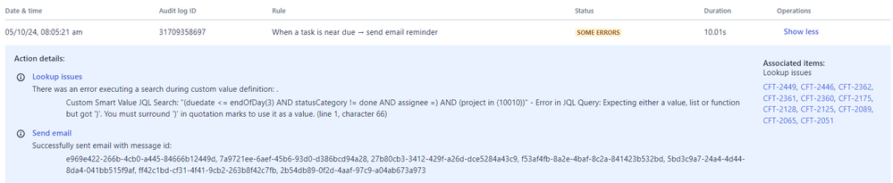

I received the following error message when trying to implement an automation rule that sends an email to the reporter when a task is due within 3 days. How do I correct the error?
Matt Parks
May 10, 2024
It looks like your JQL Search needs to be modified. Right now, part of it says "and assignee =)", so there probably needs to be a value between the '=' and the ')'

In the error message where no value is shown between 'assignee=' and the closing parentheses, that is usually an indication that a smart value has been used in the JQL, and a value can't be obtained for that smart value.
You may have a syntax error in the use of the smart value, or the smart value may be out of context at the point the JQL is used.

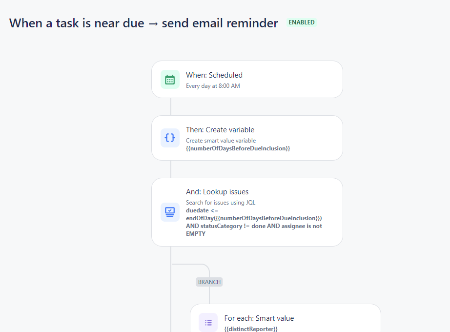

Here is the JQL statement: duedate <= endOfDay({{numberOfDaysBeforeDueInclusion}}) AND statusCategory != done AND assignee != empty

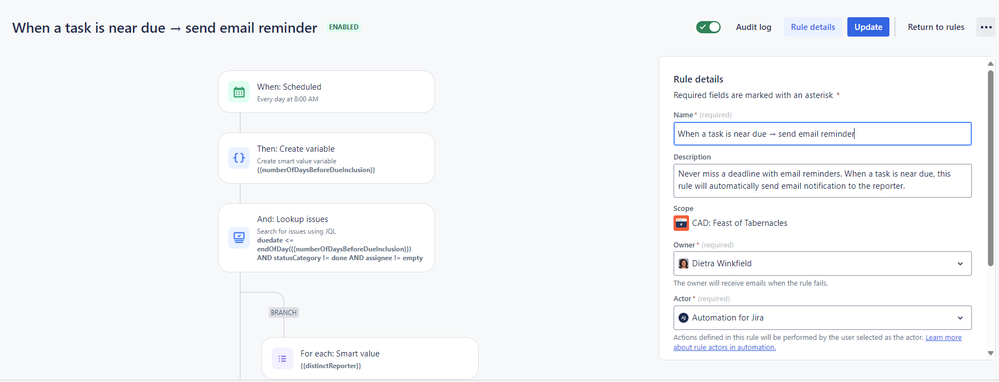

The full rule:

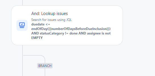

Try this JQL statement instead, making the change I highlighted in bold text:
duedate <= endOfDay({{numberOfDaysBeforeDueInclusion}}) AND statusCategory != done AND assignee is not EMPTY

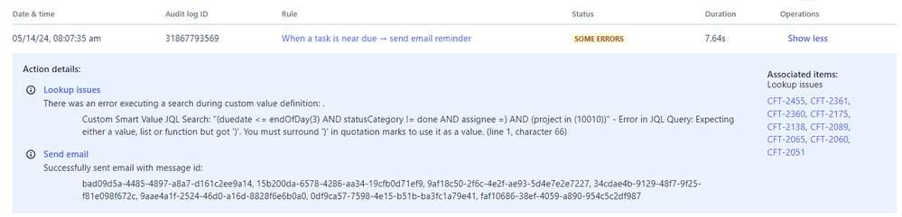

It did not work. I am still getting the error code.Screenshot 2024-05-14 093200.png
Trudy P Claspill
May 14, 2024
For confirmation of the change can you show us a screen image of the modified JQL used in the Lookup Issues action in the rule?
The error message shows an "=" after "assignee". That should not be there if you modified the JQL as I suggested.
Dietra Winkfield
May 14, 2024

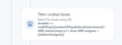

Trudy P Claspill
May 14, 2024

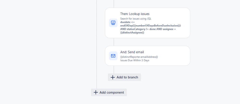

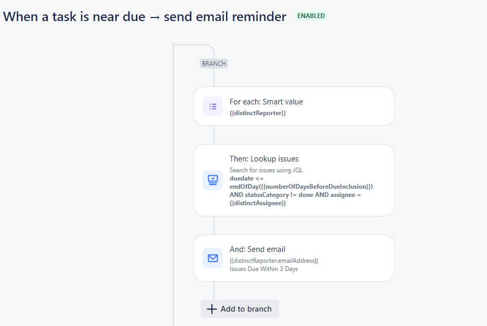

Okay, I see. The Lookup Issues action that is having the problem is the one inside the branch where the JQL includes
assignee = {{distinctAssignee}}
{{distinctAssignee}} has no value
Can you explain to us what you are trying to accomplish with this rule?
It appears that you are first looking for issues that are not done, that also have an Assignee value, and that are due within a specified number of days.

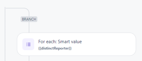

Next it appears that you are trying to set up another action, perhaps for each unique Reporter you found in the first list. Is that correct?
And then for each unique reporter you are trying to do another retrieval of issues. But I don't understand what you are trying to do in this JQL with the {{distinctAssignee}} smart value.

I want to be able to not only send the reporter a list of tasks that are coming due that they are the reporter on. I have another rule set up for the assignee to get notified.
Trudy P Claspill
May 15, 2024
Hello Dietra,
Based on your answer it sounds like there is no reason to have the AND assignee = {{distinctAssignee}} clause in the JQL in the Lookup Issues action within the branch.
It sounds like instead you need to have AND reporter = {{distinctReporter}} if you want to get the list of just the issues for each reporter to include in the email.
Do you want to give each reporter a list of only the issues reported by them that also have an Assignee value? I ask because that is how the JQL in your first Lookup Issues action is written. If you do want to include only the issues that have an assignee then your JQL within the branch should be
duedate <= endOfDay({{numberOfDaysBeforeDueInclusion}}) AND statusCategory != done AND assignee is not EMPTY AND reporter = {{distinctReporter}}

Dietra Winkfield
May 20, 2024
Your suggestions in the first two paragraphs fixed the problem. The automation is now working as I want it to. Thank you!
