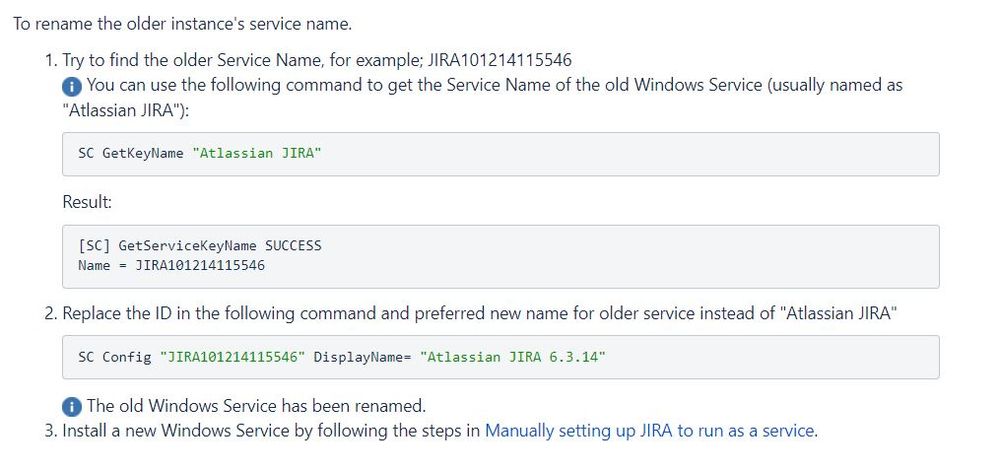

Craig Nodwell
May 20, 2022
Remove the old service and create a new one.
running-jira-applications-as-a-windows-service
zalim786
May 20, 2022
remove using regedit oder run?
regards
zalim786
May 20, 2022
it has been marked for deletion.
i am starting the server new.
Wait please.
Thanks for your help.

Craig Nodwell
May 20, 2022
You can try doing this as well.
