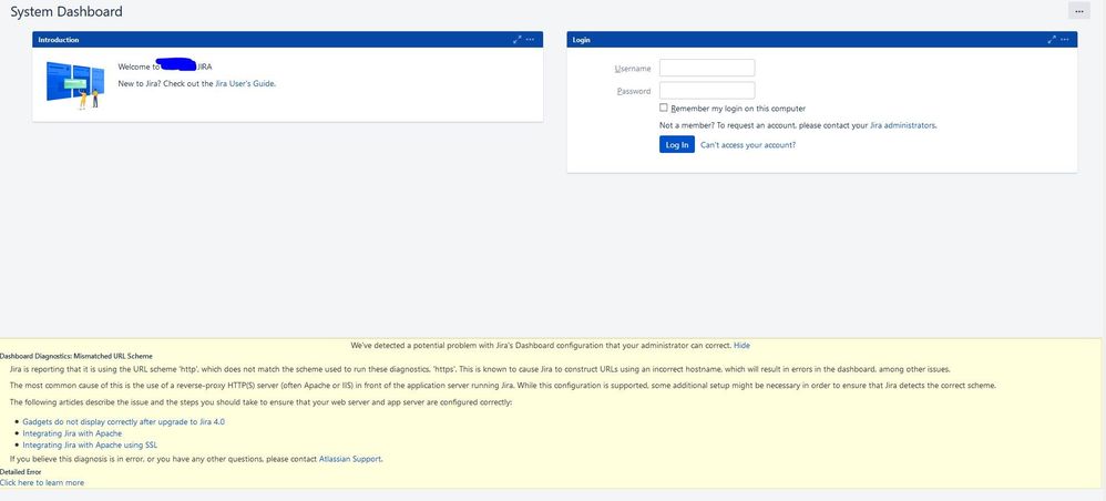

I have done all the possible settings for the error message: We've detected a potential problem with Jira's Dashboard configuration. Click here to learn more. I can't get it resolved.
All the Jira functions are working correct also the health page shows no error's. Is this maybe a bug?
We connect this server trough a nginx resverse proxy for ssl offloading.

June 13, 2019
Hi,
I found the problem. If i set secure= on false or true the error is there. If i remove the secure thing from my connector the problem is resolved. If i set it on false it set some urls to http.
This question can be closed.

Can you please take a screenshot with the error message? Make sure to hide any confidential information.

Mark Rolink
June 11, 2019
Hi Fadoua,
Thanks for reacting on my help request. See attachment for the screenshot. Everything within Jira works fine only the message stays.  This was the upgrade to Jira 8.2.1.
