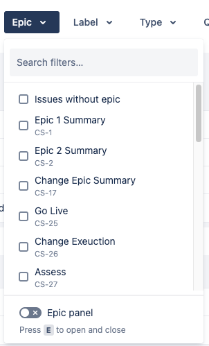

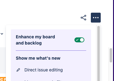

If you use the new Enhanced My Board and Backlog option you can opt to not display the Epics panel, but that does not result in the Epics displaying as cards in either the Backlog or Active Sprints views.
That adds an Epics filter to both views. In the Backlog view at the bottom of that filter is an option to turn on/off the Epics panel.

I have the same issue and here's how I solve it. On the right panel view settings, the last option is a toggle to show or hide the Epic label. I'm am doing this in a scrum company manage board.
