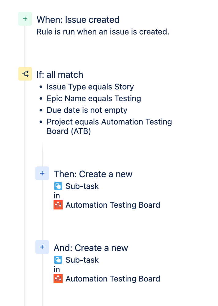

Here's the tree as I have it built currently. The automation is executing (not failing) but for some reason, it doesn't seem to be working.
I rule I am trying to create is:
  • When a story is created in a project that has the epic link "Testing" and a set due date, 2 subtasks will auto-populate.
I took the majority of the settings from my TMP, where the automation ran perfectly. The only fields that I added to this tree were the project name and the epic name components, but for some reason, adding those stop the automation from working Screen Shot 2022-12-22 at 9.21.08 AM.png

Nevermind! I figured out what the problem was. Instead of using the component for epic name = Testing, I changed the component to a JQL for epic link = Testing.
