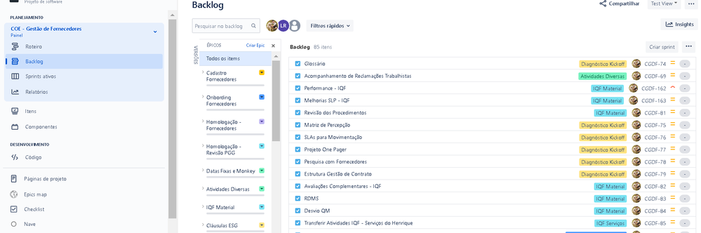

2-) The original panel with all historys and epics:

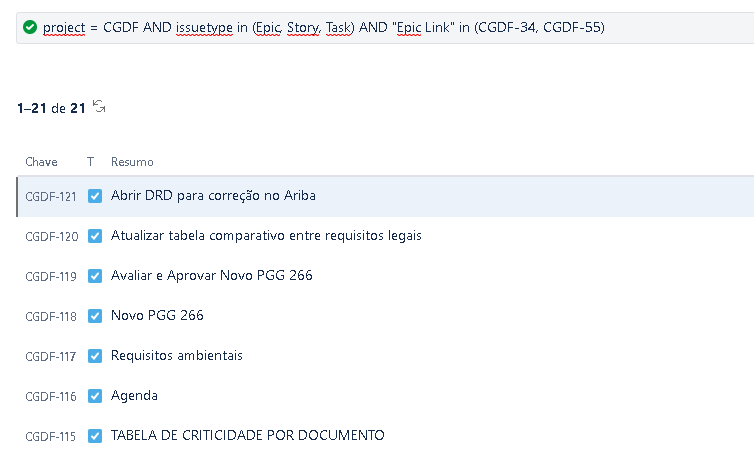

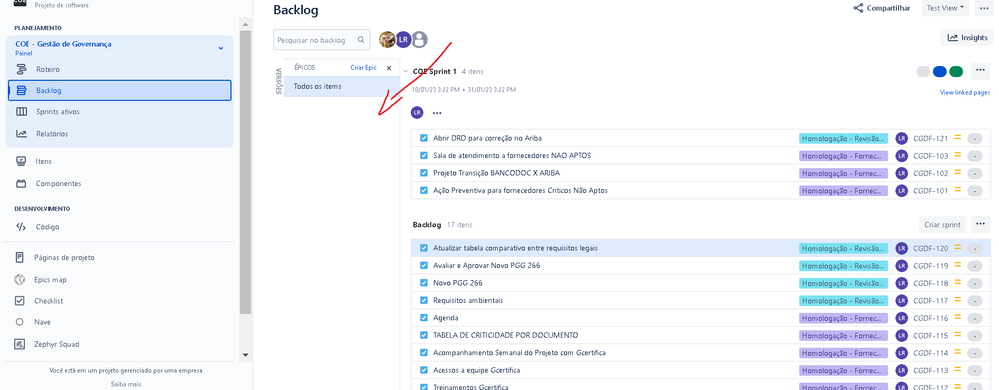

3-) When i use this filter I pulled only the historys from the especific epic. That way i can create a new sprint and use the roadmap, diferente from the original panel.
Cod.: project = CGDF AND issuetype in (Epic, Story, Task) AND "Epic Link" in (CGDF-34, CGDF-55)

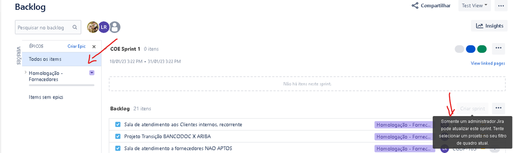

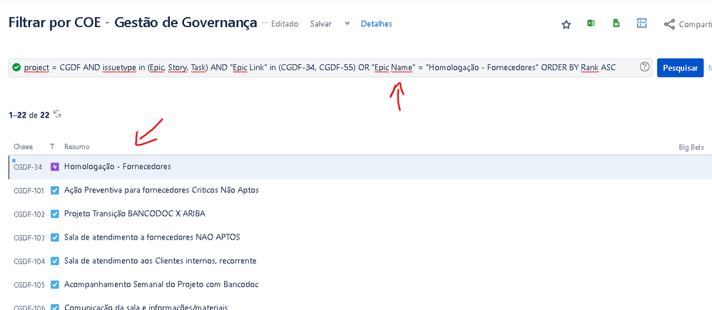

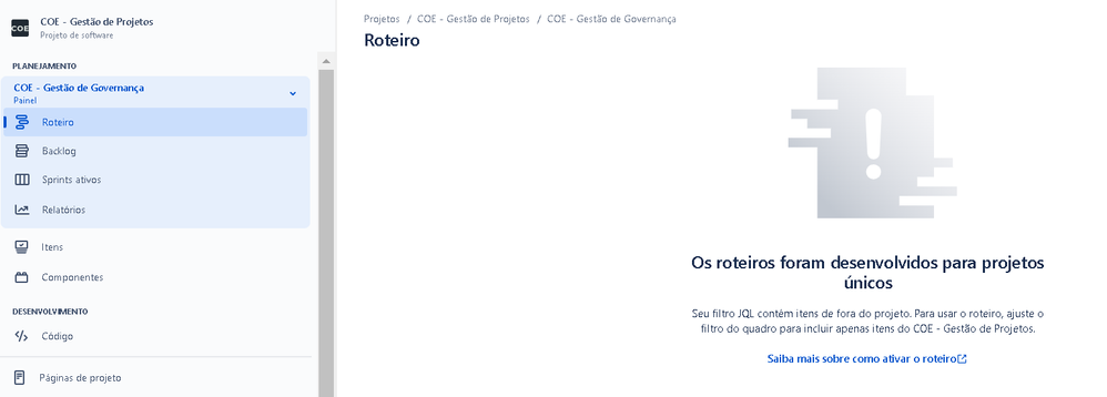

4-) When I try to use this second code I manage to have my epics but I can't open a sprint and use the roadmap.
Cod.: project = CGDF AND issuetype in (Epic, Story, Task) AND "Epic Link" in (CGDF-34, CGDF-55) OR "Epic Name" = "Homologação - Fornecedores" ORDER BY Rank ASC
the message that appears says: Only a Jira admin can update this sprint. Try selecting a project from your current filter.

The issue is you have used an OR operator without any parentheses in your filter:
Jira is eval this as two filters, essentially. The first one is
and the second one is
The second one does not place any constraints on which project the issues should be in. Therefore, Jira evaluates that the issues may come from any project in the entire Jira instance. That would include Jira Service Management projects. You would have to have Manage Sprints permissions in absolutely every project in your Jira instance for this to work.
What are you trying to retrieve with the second half of that filter? As it is written, it would retrieve just Epics that have their Epic Name set to "Homologação - Fornecedores". It would not retrieve the child issues of such Epics.
Additionally, with the first half of the filter are you trying to retrieve just the child issues of the specified Epics, or do you also want the Epics themselves? I notice in the second image in your post you pointed to the Epics panel, which is empty, as if you expected Epics to be listed there. If you want the Epics as well as the child issues then that part of the filter needs to be changed thus:
project = CGDF AND issuetype in (Epic, Story, Task) AND ("Epic Link" in (CGDF-34, CGDF-55) or issue in in (CGDF-34, CGDF-55))
