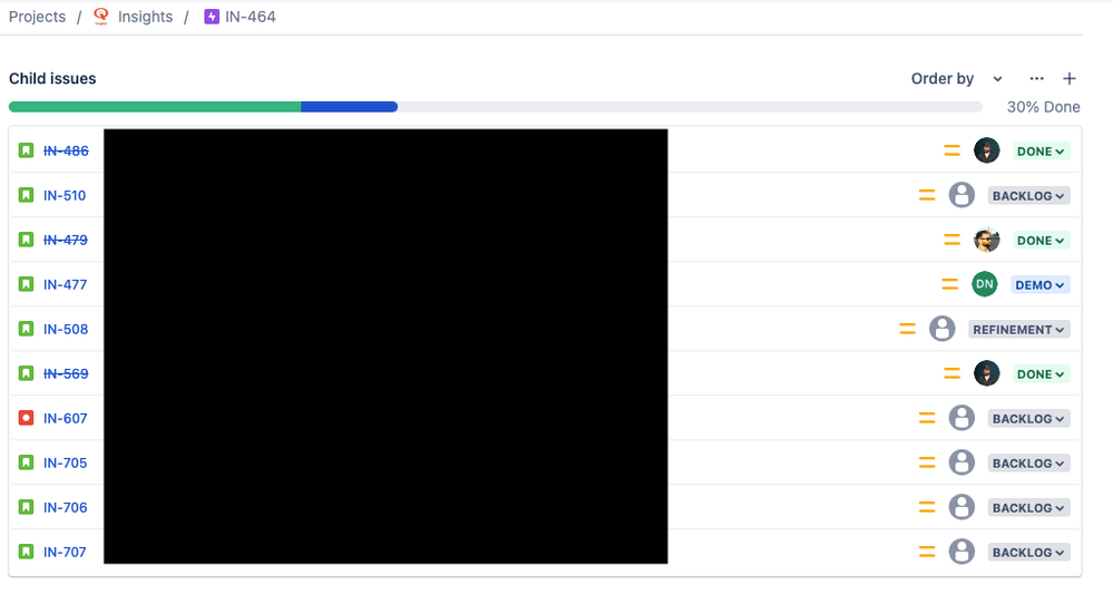

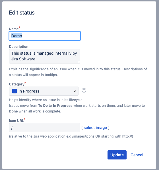

We have a status we created "Demo" which has a status of "In Progress". (See Image)
When I look at an epic's full detail "card" and see "all" the "child issues" associated with that epic I do not see issues that are in the state "Demo". (See Image)
Anyone know how to make sure an epic view shows all it's child issues no matter what the status is?

Though this was not a board. I was able to take steps to fix the "filter" that impacts how "Child Issues" display on  Epic Cards. I will share my steps and images below.
Thank you for suggesting this could be a filter issue.

Hi Lauren - Welcome to the Atlassian Community!
Can you share the screen you are looking at which does not show all of the Epics?
Also, what category of status is the Demo status? To Do? In Progress? Done?
Lauren Gordon-Fahn
November 29, 2022
Demo has a status of "In Progress"
Requested Image has been added to the main request for help above.

Lauren Gordon-Fahn
November 29, 2022
I just found the solution. I will list it below. Thank you so much for your time and help.
