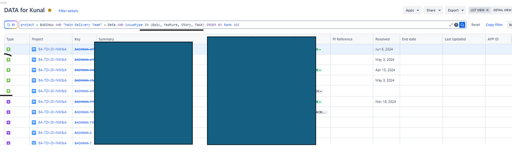

@Jack Brickey  I did checked that , when I setup the filter it showed me everything , but when I go on the board it will only bring subtask and epics

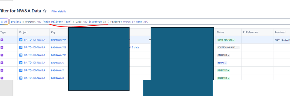

@Jack Brickey  with just filter as feature and  other one is with feature, epic, subtask , I see below Capture 1.PNGcapture 2.PNG

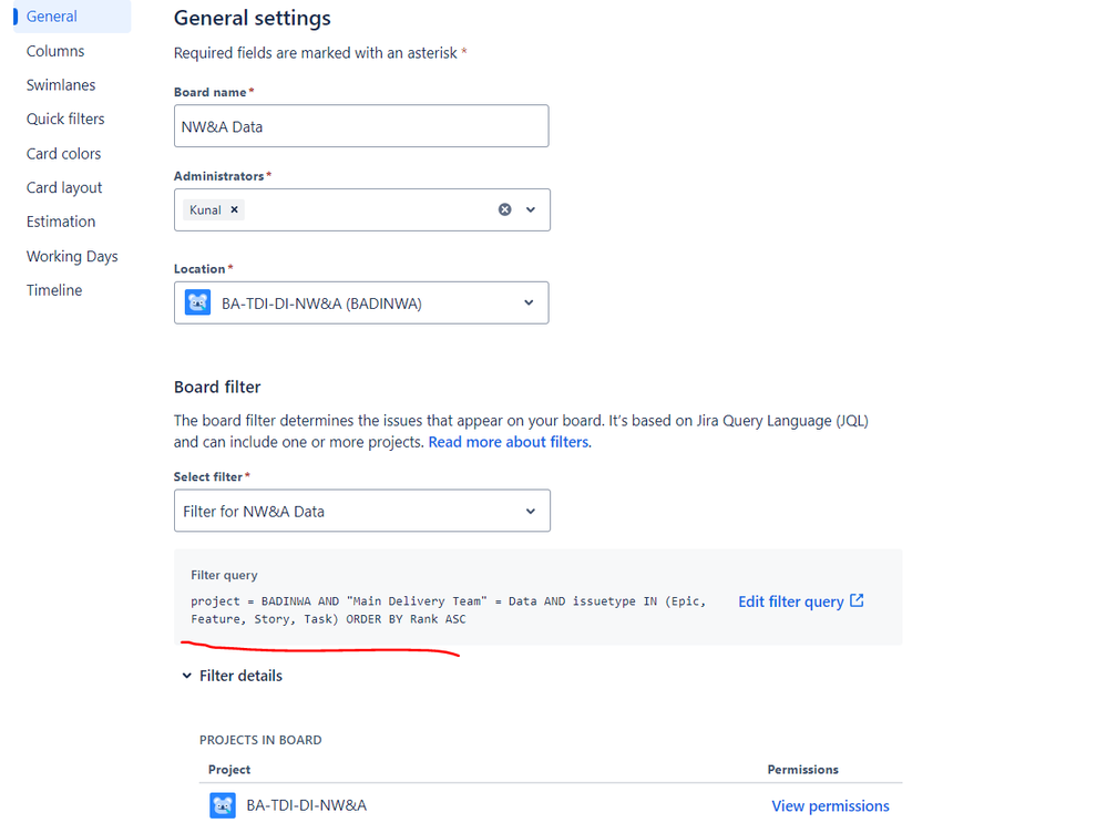

Hi @Kunal , if this is a Company managed project please check the board configuration to see if the board's filter might be the reason these issue types are being excluded.
  1. click on ellipses in upper right of board
  2. in the General tab check Board filter
Please feel free to share a screenshot of your board if this doesn't help.

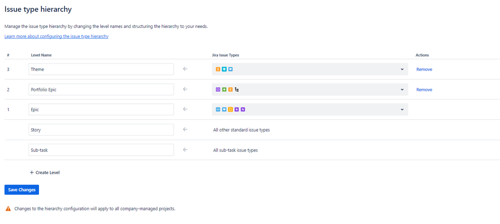

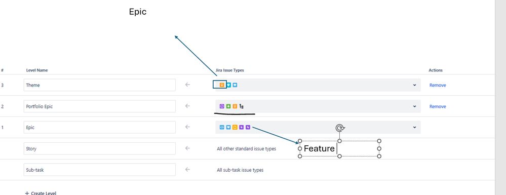

@Kunal , what level is the Feature issue type? By default, Jira comes with Epic as a level 1 issue type, and Story as a level 0, subtasks are -1 below Story. I was assuming you created a feature issue type as a level 0. Laura's response gave me pause to question this.
Jack Brickey
January 10, 2025
I don't see Feature?

@Jack Brickey  should it be in level 1 , 2 or 3 ?
Jack Brickey
January 10, 2025
Well I guess that is up to you. What does a feature mean in your process? Will a feature include epics or will features be implemented within the context of Epics?
Kunal
January 10, 2025
It will be epcis--> feature-- > subtask
Jack Brickey
January 10, 2025
It seems to me that you need to create a new issue type called feature and set it to level 0. Basically you want a feature to equate to a Story. Please note that a level 0 issue type is intended to be completed within a single sprint. So if a feature takes more than a single sprint. Then you might want to consider using Epic to represent a feature.
