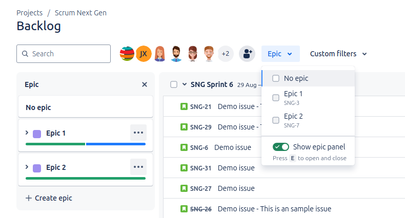

As far as I know the epics of team-managed boards can only be displayed in the epic-panel and not as backlog-items or cards on the board.
This is how I can visualize epics in backlog of my test project:

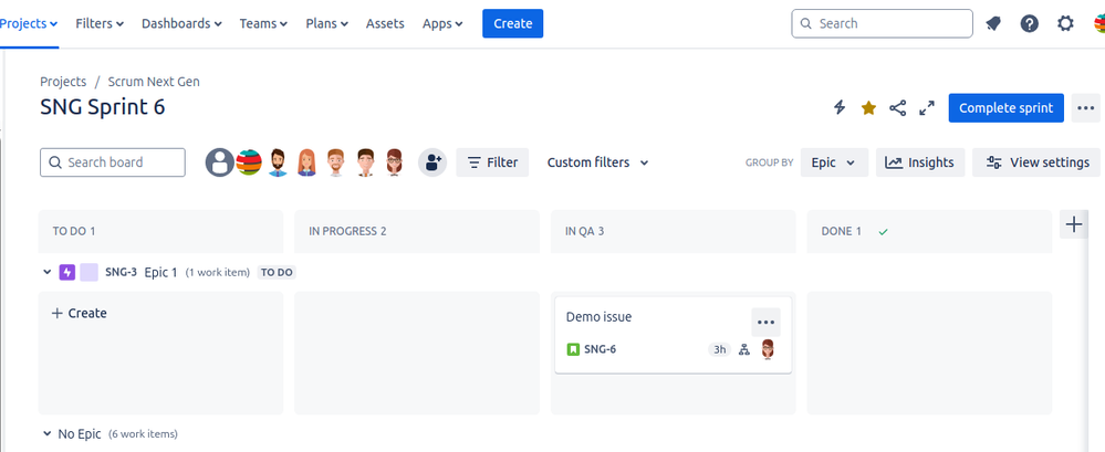

Also you can choose to display swim-lanes by epics:
Did you try these as well? Maybe you can provide some screenshots.
