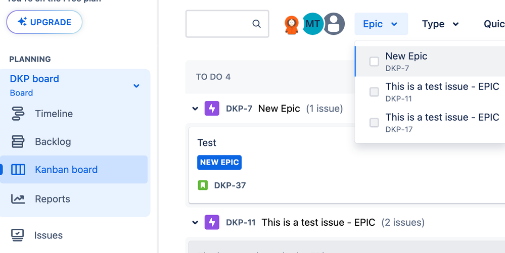

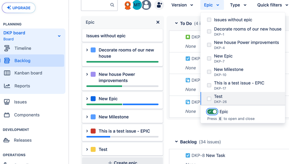

Example 6 Epic's in the project and on backlog, but only 3 on the board with the same default filter option
Backlog
Kanban board
