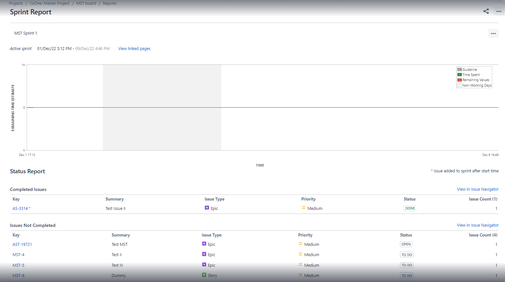

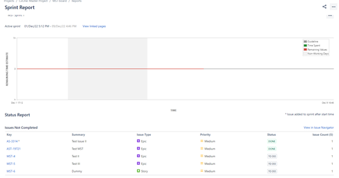

@Ravi Sagar _Sparxsys_  For some reason the sprint report doesn't show Completed issues when we tried today. Any ideas?
Sample I:
Sample II (worked one week ago):

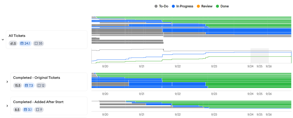

We can help at minware - here is an example of the grouping for issues / tickets and would be easy to do something similar for epics if you want to discuss your requirements:

Sagi Gueta
February 2, 2023
The issue solved! Apperntly the problem that we encountered with was connected to the face that the board's statuses weren't in a good order (done should be on the RIGHTEST spot between the statuses).
Now the data is fixed and we managed to create good reports in eazyBI as well.

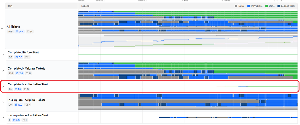

Eventually you will run into some limitations w/ easyBI:
(1) https://jira.atlassian.com/browse/JRACLOUD-75868 <- tickets added after the start of a sprint
(2) https://jira.atlassian.com/browse/JRACLOUD-62109 <- rolled up story points
(3) https://jira.atlassian.com/browse/JSWCLOUD-18677 <- drilling down to subtask level

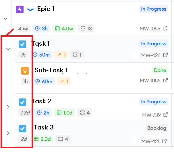

These are available "out of the box" in minware due to our ability to blend Jira + Git data as well as a ton of other metrics to help your teams improve estimation.
(1)
(2) / (3)
Let me know if we can ever help!
