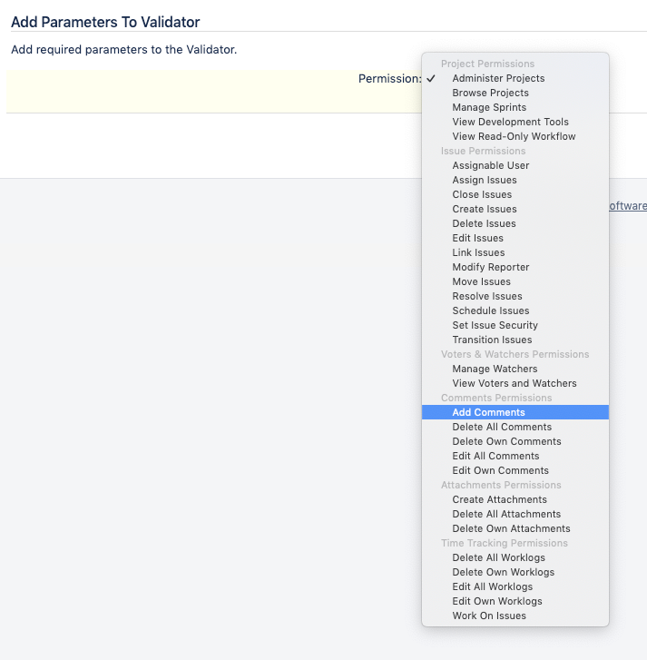

Thorsten Letschert _Decadis AG_
November 14, 2019
Hi @Gordon Fang ,
speaking of Jira Server you'll need an additional 3rd party app that extends workflows, e.g. Jira Workflow Toolbox, Jira Misc Workflow Extensions, Jira Suite Utilities or Script Runner.
Speaking of the first one in line, Jira Workflow Toolbox, you'd just have to add a Fields required validator (https://apps.decadis.net/display/JWT/Fields+required+or+changed+validator) and choose your Due Date there.
Cheers
Thorsten
Stephen Crandell
November 12, 2019
The schedule issue permission.
Stephen Crandell
November 12, 2019
@Gordon Fang my suggestion is to:
  1. create a screen to use for the transition to In Progress and add the due date field to that screen
  2. add a validator in the workflow to ensure that the due date field is filled out.
Gordon Fang
November 12, 2019
@mrcrandell.sw Thanks for quick response.  I am stucked on adding a validator.  Which permission is for due date filed?
