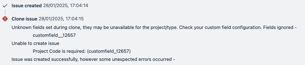

However, when I test this workflow by filling out a new form, the ticket cloning fails with the following message:
As answered under @Marc -Devoteam- thread, the problem seems to be a typo on your advanced fields JSON.
Having double underscore in between customfield and its id 12657 is causing the failure, as the instance can't understand where to put that information as a customfield__12675 is unlikely to exist, and the required field customfield_12657 which is mandatory field isn't being populated -> causing the failure on creating issue.
I hope that solves the problem.
Bests,
Marcos Defina.

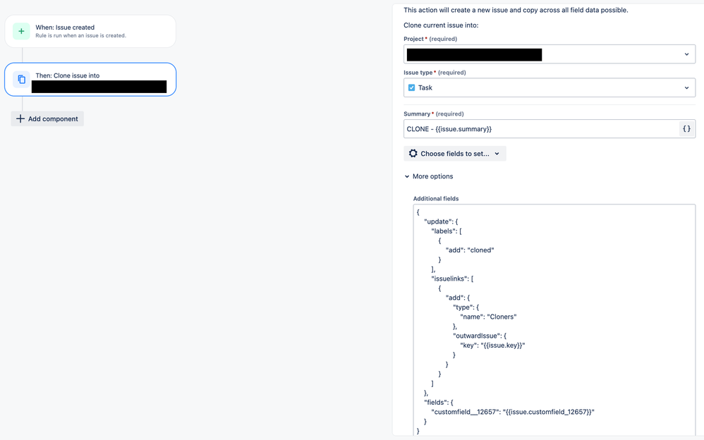

Thanks for this suggestion!
The clone operation already has some JSON code, here it is with the addition of your code above:
I've placed your code snippet where I gather it belongs based on this article.

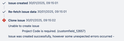

However, my error message now reads:
Is the field available on the other project?
And is the rule scoped for both projects?
Why the double underscores? seems like this is the problem - your Project Code customfield is required, but you're given something the instance doesn't understand customfield__12657.
Fix the typo, and most likely it will work!

That's ok Matt,
It's quite common to just reuse the code you already wrote in other automations, that brought the initial error to your sandbox test too.
It's just the double underscore as highlighted in other comments.

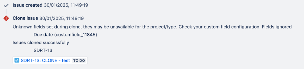

While cloning works for me now, when I try to copy a custom field (in the example below, 11845 is 'Due date'):
I get the following error (note: I also get this error when I remove the custom JSON field, above):
Does this mean that the destination (software) project is not configured to accept this custom field? If so how do I go about this configuration? If not, what should I alter in the service project?
If either of you can point me to documentation that describes how to correctly propagate custom fields during cloning I'd really appreciate it.
On the custom field context there is probably an/or issue type restriction an/or project restriction.
Also the field must be on the screens used by the project.
Check this with your Jira admin if you don't have permissions as admin or in the other project
