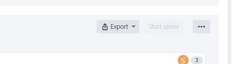

Hi all, I am having the above issues. I have not had any issues in the past 6 months this is the first time.
Please find screenshot for reference. I have amended the dates and still no access. JIRA Error.JPG

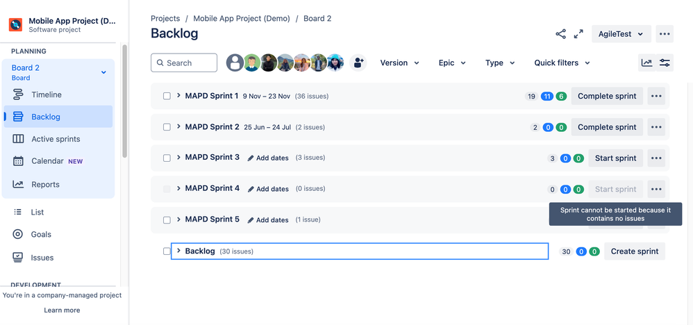

Hi @Porsha Shakoor Can you provide a full screenshot of your backlog and move the mouse over the greyed-out text like this?

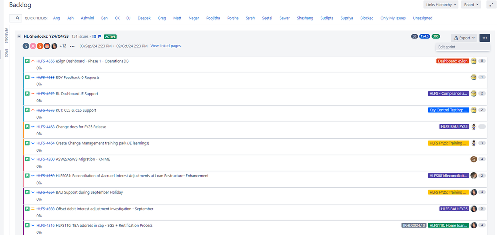

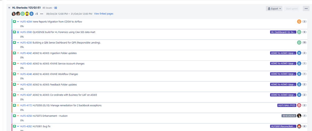

Porsha Shakoor
October 14, 2024
Hi Teresa,
Please refer to screenshot below:
