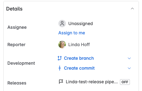

The screenshot shows the project where it works:Screenshot 2025-07-28 at 14.29.17.png

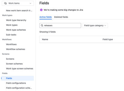

  • There is no field.

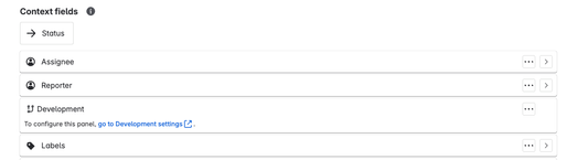

  • Layout comparison (not working vs working). In the UI, releases panel is displayed directly under "Development". In the project that doesn't work, I cannot find "Development" to add to the layout (the right column):

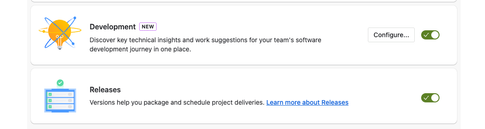

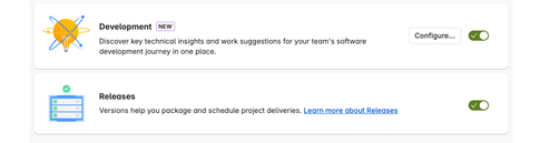

  • Project settings (both are the same):

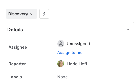

Sorry @Tomislav Tobijas , I forgot to answer "Where "Releases" field is not visible, can you still see other "Development" fields/options?"
No, I cannot.
This is what it looks like:
