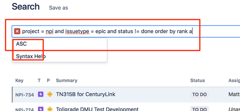

@Audra Bonacki, can you try to add " ASC" to the end of your query?

Ok, did that.

For what it's worth, just typing "rank" into the search definition is not going to help.  "order by rank" is what you need.

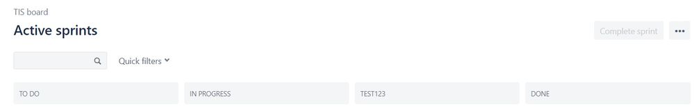

Hi Oman, I'm trying to enable ranking. When I look at Field Configurations, Rank is locked even though the Default Screen is listed. According to the Atlassian Documentation, on the board, I should see 3 dots. I do not. I am a JIRA Admin so I have all permissions. The board is an existing board, I did not set it up.

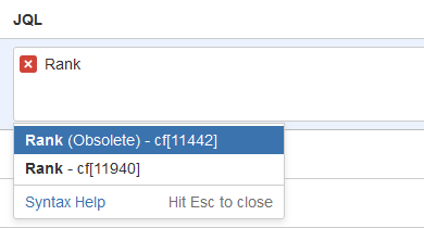

To Nick, I tried that, it did not work. When I type in the JQL order or even "order with quotes, no options populate. When I type Rank, I get these 2 options Capture.PNG
To Oman, the team would need to enter the rank manually and also want to know if once a ranked ticket is completed, does the next one automatically move up? I do not have 3 dots on the backlog or active sprints pages.
