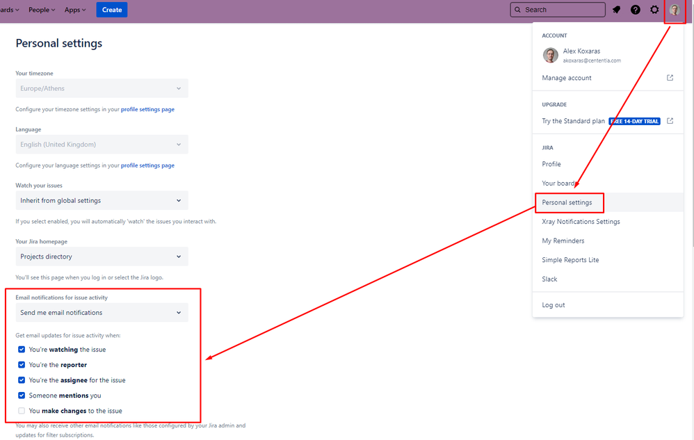

A user can turn off all notification from his/her profile. If that is the case, he will not receive most of notifications.

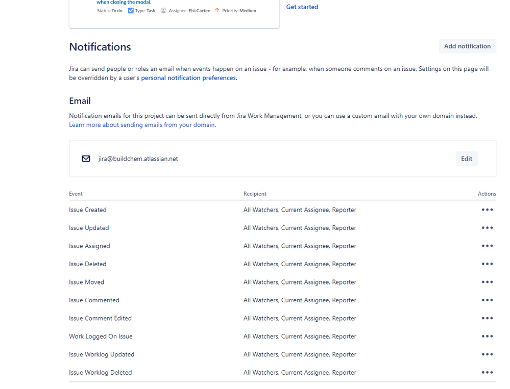

You could also check the configuration of the notification scheme of the project (Settings > issues > notification schemes > choose the relevant scheme).
In the notification scheme, check the column notifications if the right roles are determined for the relevant events.

Personal notification are on.

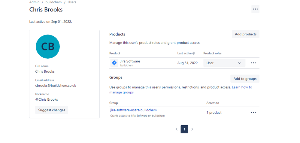

He has access for everything and
I need to wait with screenshots till Tuesday, as he doesn't work Fridays and Mondays.
He has product access; Personal notifications are on.
I don't know how to check the rest of the list
He did, and everything looks ok. he has access to everything, but he doesn't receive notifications by email

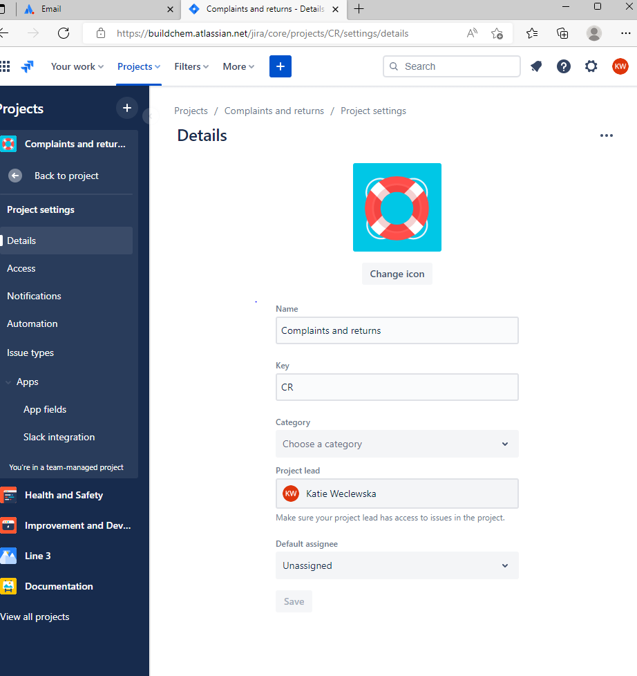

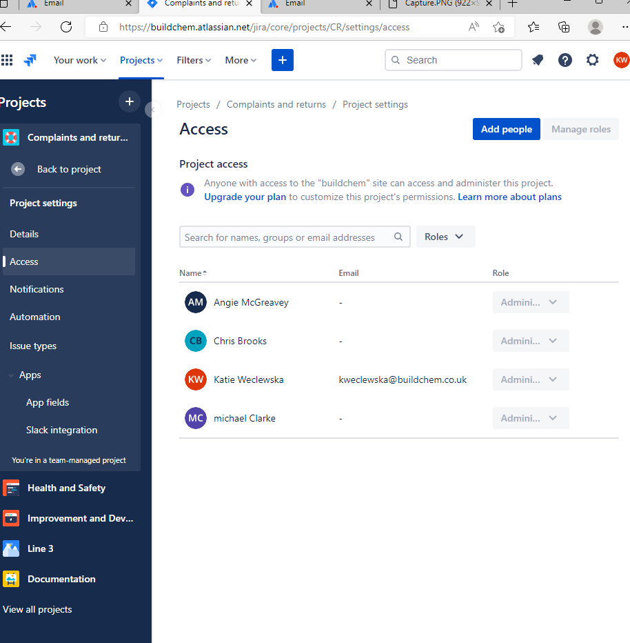

Ok, so you are on a Team Managed Project. "Access" is fine.
Can you also share screenshots of Notifications?
The rest of the two team members, receive notifications?
@Katie Weclewska and you are absolutely certain and positive that your managing director has logged in at least once on your jira instace?
Yes, I asked him, and we checked his profile settings, so he was logged in. Otherwise, I couldn't check his settings.
@Katie Weclewska ok, but I want to be clear about this:
You managing director might have an Atlassian account and be logged in to another instance. If he/she hasn't accept the invitation you sent about your instance, then he/she will not receive any notifications about this specific instance.
Can you cross check from your instance the last time he logged in?

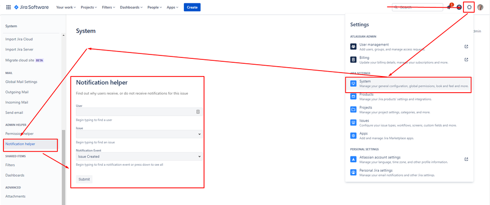

@Katie Weclewska go to Notification Helper
https://YOURSUBDOMAIN.atlassian.net/secure/admin/NotificationHelperAdmin.jspa
Paste here the results please.

Please follow these steps:
And instead of typing something, it would be better if you could share a screenshot.

He is active on each product, and last time, he was active 31st of August
